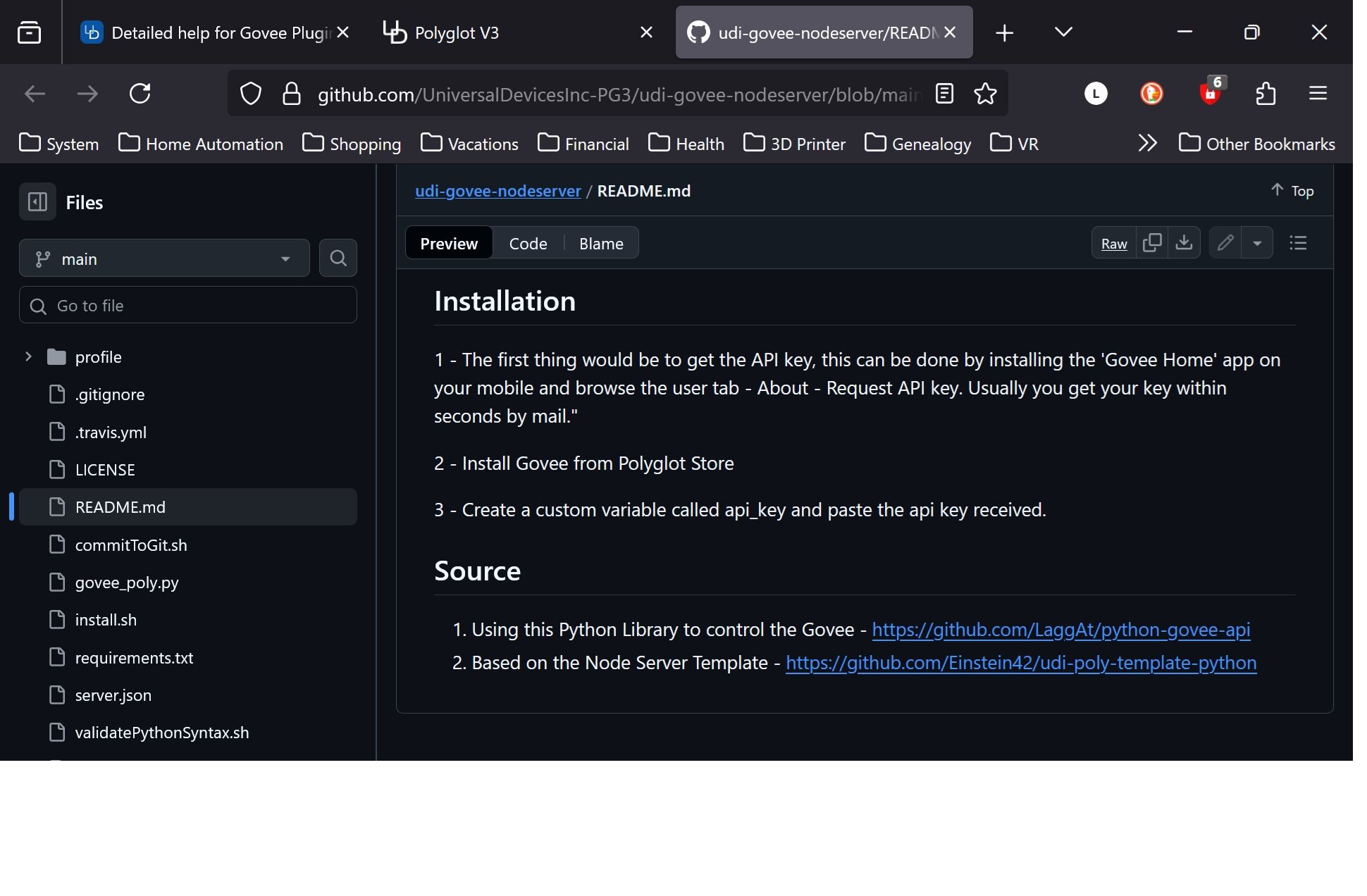

Also, in the store listing for each plugin I would expect a "more info" option.  From there you will often find some very basic instructions relevant to each plugin.  For Govee, it takes you here:
https://github.com/UniversalDevicesInc-PG3/udi-govee-nodeserver/blob/main/README.md
Once installed and set up, mine found the three Govee devices that I have and once found, the IoX showed the Govee devices as nodes, which can be used like the Insteon or zwave nodes in programs and scenes (with some limitations).

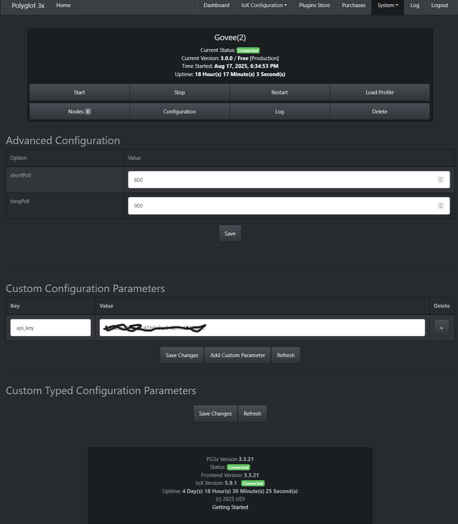

Here's where I'm at so far:
1. Install Govee Plugin from Polyglot V3 Store. COMPLETE
2. Obtain API Key from Govee Home. COMPLETE
3. Configure Govee Plugin as detailed in README.md. MAYBE COMPLETE?? See below
Now what? Am I done with configuration? Is there anything else to complete while still in Polyglot?

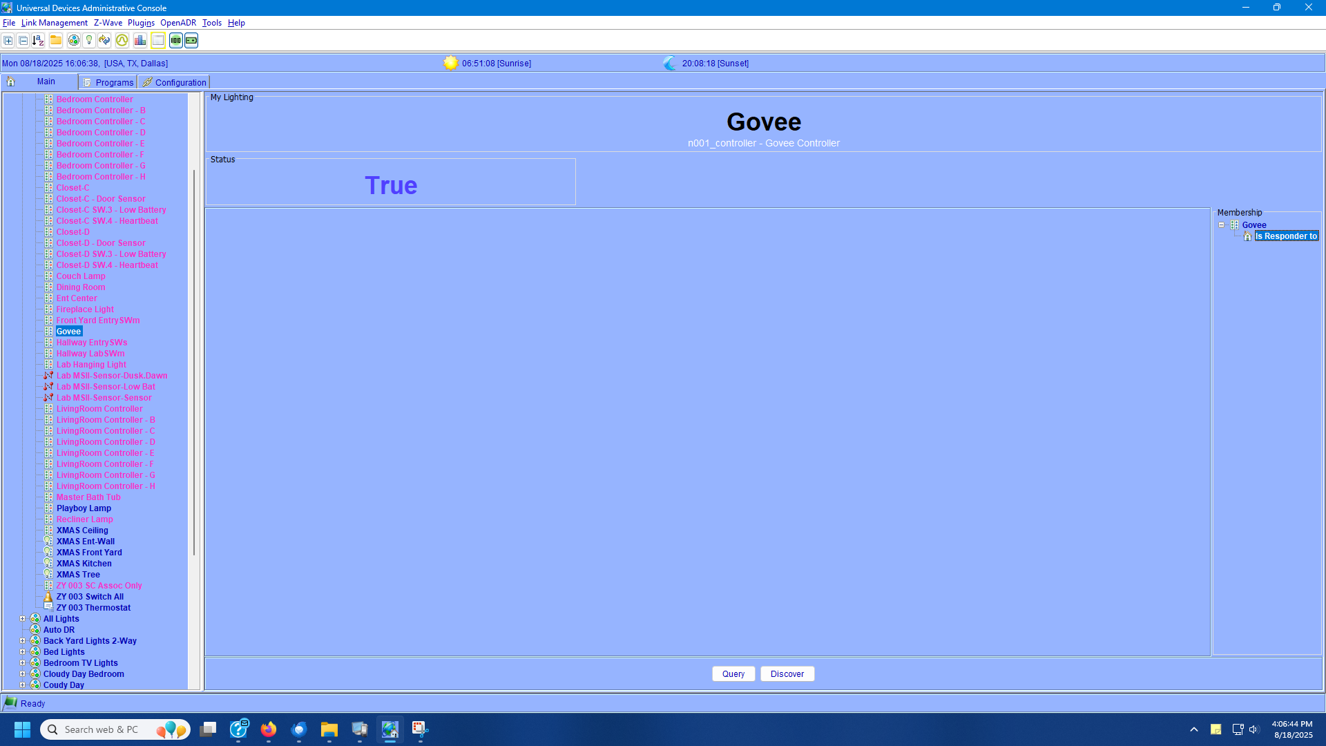

Open your Eisy admin console. You should see the "Govee" plugin in the admin console network list. Click on it and then click on discover. It should discover your Govee lights.
I've got the Govee plugin, but when I hit discover, the only thing that happens is the discover button sort of fades in and out. I've waited for a long while, and nothing else seems the change. Where are the Strip Light 2 Pro supposed to show in the admin console? Here's what I'm seeing, after I hit discover.
They should show up under "Govee" in the admin console. If you have one set of Govee lights, you should see two nodes in the Govee plugin. If you don't, restart the plugin.

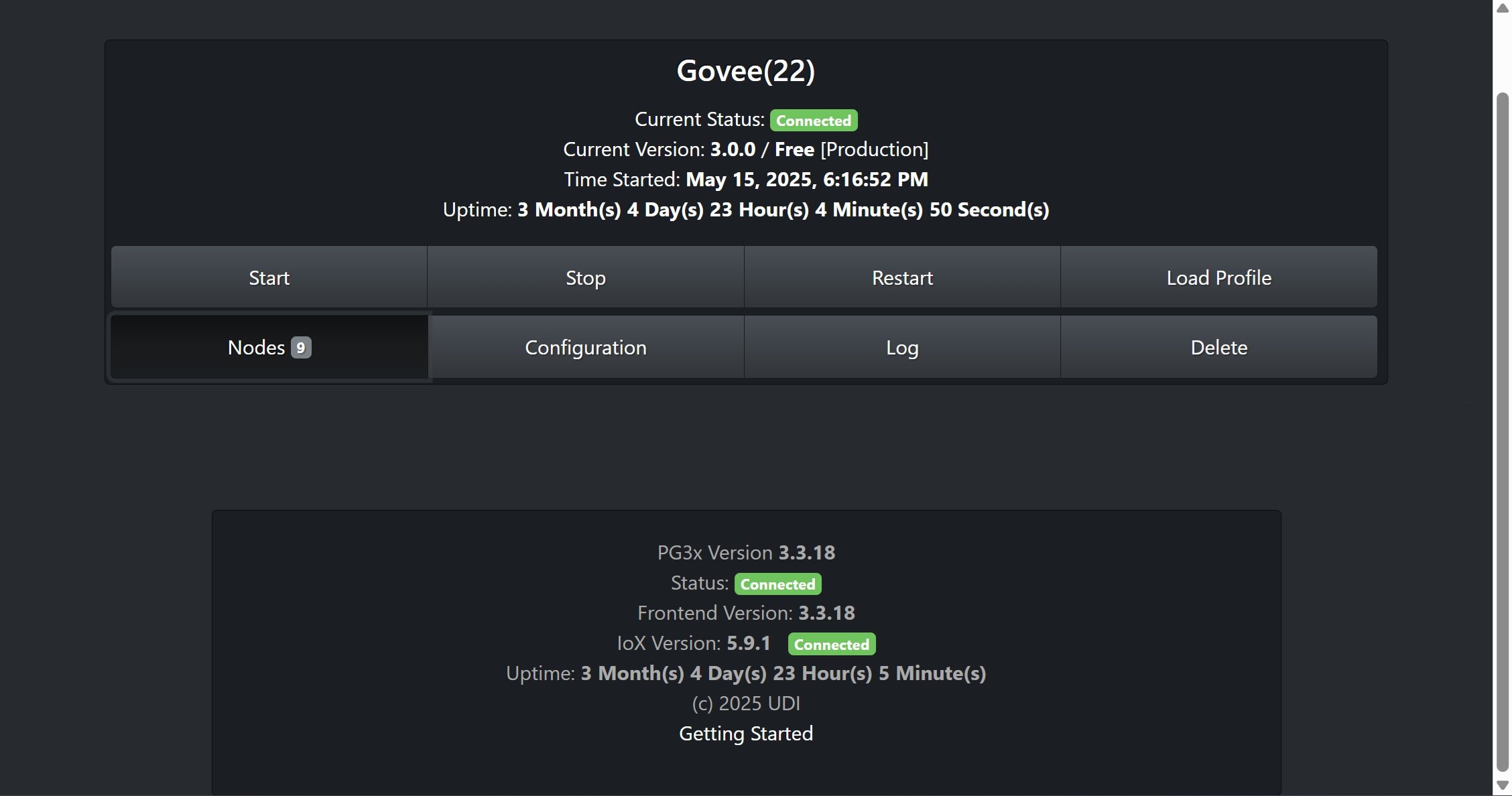

How many nodes do you see in the Govee plugin page? Where you see 9 in mine, you should see 2 in yours. One node is for the Govee controller, and one node is for your lights, with the name you gave the lights in your Govee app.

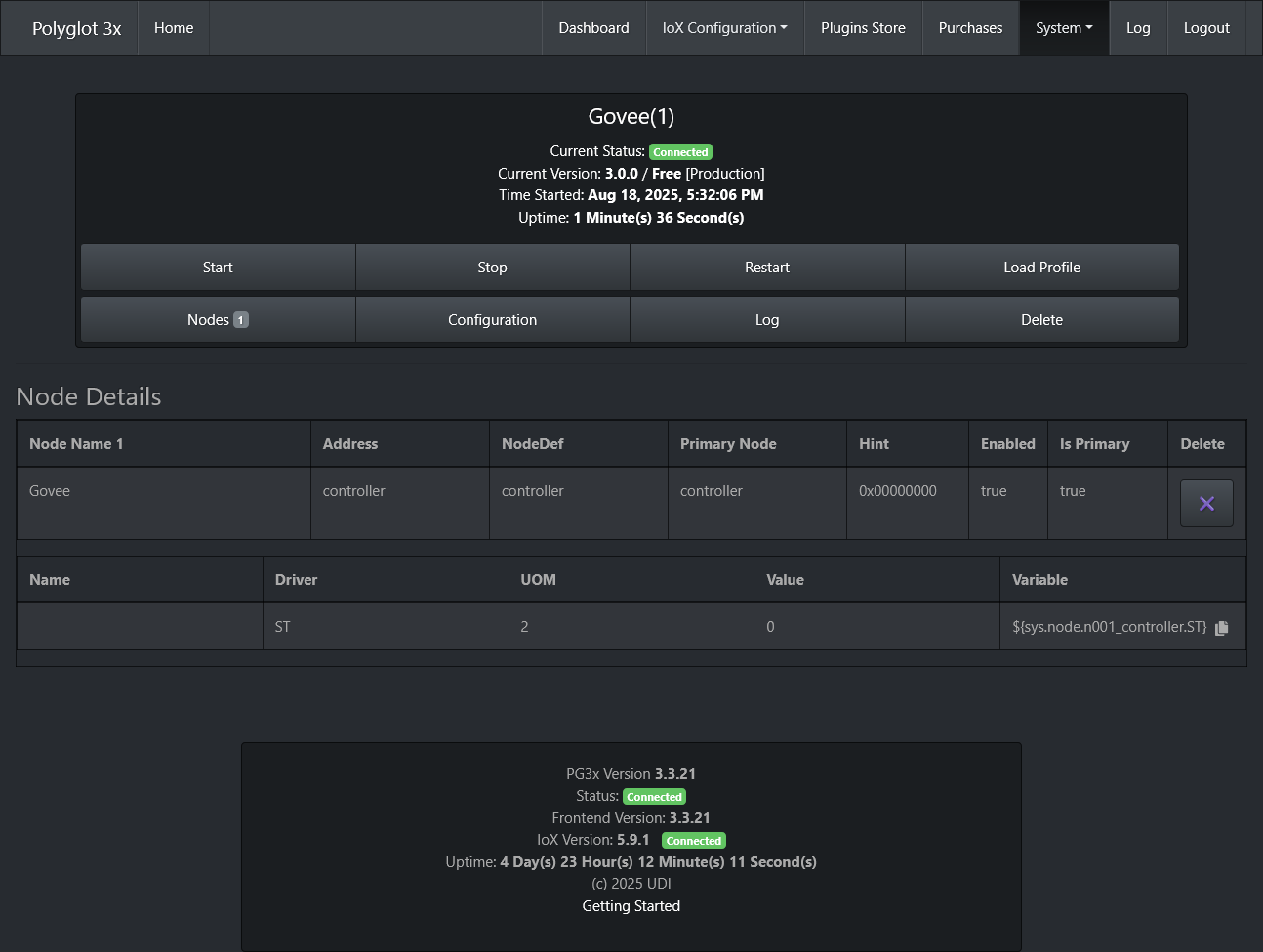

I only have the controller showing. Not the Strip Light 2 Pro I just installed. I can control that with my Fire Tablet running the Govee Home app, and my Echo's as well, just can't seem to get the eisy on-board. Here's my Ployglot page: Screenshot2025-08-18at17-33-47PolyglotV3.thumb.png.8665aad40f9e7a5dd0ee0b5ab5ca84bc.png
See, no lights. Is there some kind of naming convention I missed? My name is: "Kitchen Strip Light" in the app.
Thanks again for spending some time on this. Cheers!
The Govee plugin controller will use the same name that you use in the app. Try pressing the restart button in the Govee plugin? Then try pressing load profile. The Govee lights must appear in the Govee plugin, or they won't appear in the admin console.
