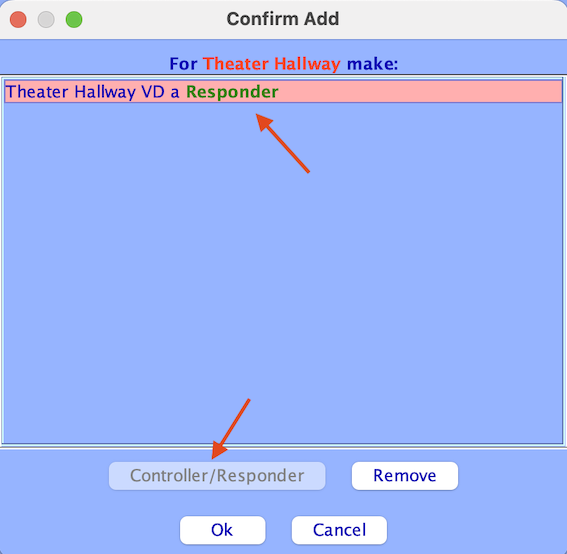

Created a virtual dimmer but it only allows the option to add it as a scene responder.
{"id": "30", "type": "dimmer", "name": "My vd Name"}
Device type in AC shows as Virtual Generic

Virtual Dimmer only allows adding as a scene responder. Controller/Responder is greyed out.

I can add them but there is a design choice here: Insteon uses DON/DOF as 100% / 0% not brighten / dimming.  Currently the dimmer / generic device does not have those commands.
option 1:  add DON/DOF commands as 100% / 0%, this is most consistent with UD scenes which are aligned with insteon scenes.
option2: use the current brighten / dim which move the percent by 3% I believe.  I would just send the DON / DOF command along with the current command.  This might be more useful considering the device but confusing for scene consistency.
thoughts?
IMHO option 2 makes the most sense for a virtual dimmer, otherwise with option 1 it behaves like a switch.
A virtual dimmer should function in the same way as a physical dimmer or a keypad button added as a scene controller. Holding a Dimmer or Keypad button down brightens or dims a scene. Pressing a keypad button turns a scene ON or OFF.
One of the most useful applications for a virtual dimmer as a scene controller is for multi-way circuits.
Consider a common 3-way lighting circuit where 2 physical dimmer switches are added to a "3way" scene, both as controllers. BUT in IoX if you control any of the 2 dimmers directly, the other isn't in sync and neither is the scene. The virtual dimmer solves this dysfunctional behaviour where everything remains in sync as it should be.
