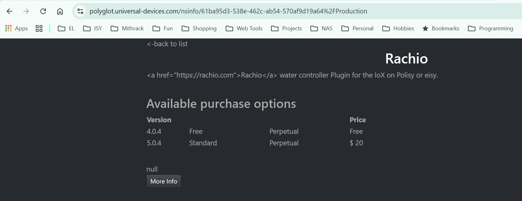

September 3Sep 3 Clicking the Rachio button in the Plugin Store takes me to a page with no buttons other than a "More Info" button that dumps me into the GitHub repo. What do I need to do to install the latest version and pay? I have a shiny new Rachio all connected to my sprinkler valves and my garden is drying out
September 4Sep 4 @skydvrz you've got to go through the eisy web interface and find the plugin store through that. Looks like hte site you went to is just the list UD keeps for the plugins available. https://wiki.universal-devices.com/Eisy:User_Guide#eisy_(PG3)_Dashboard Once there it should have install options as shown in the wiki: https://wiki.universal-devices.com/Eisy:User_Guide#Plugins_Store_Menu
