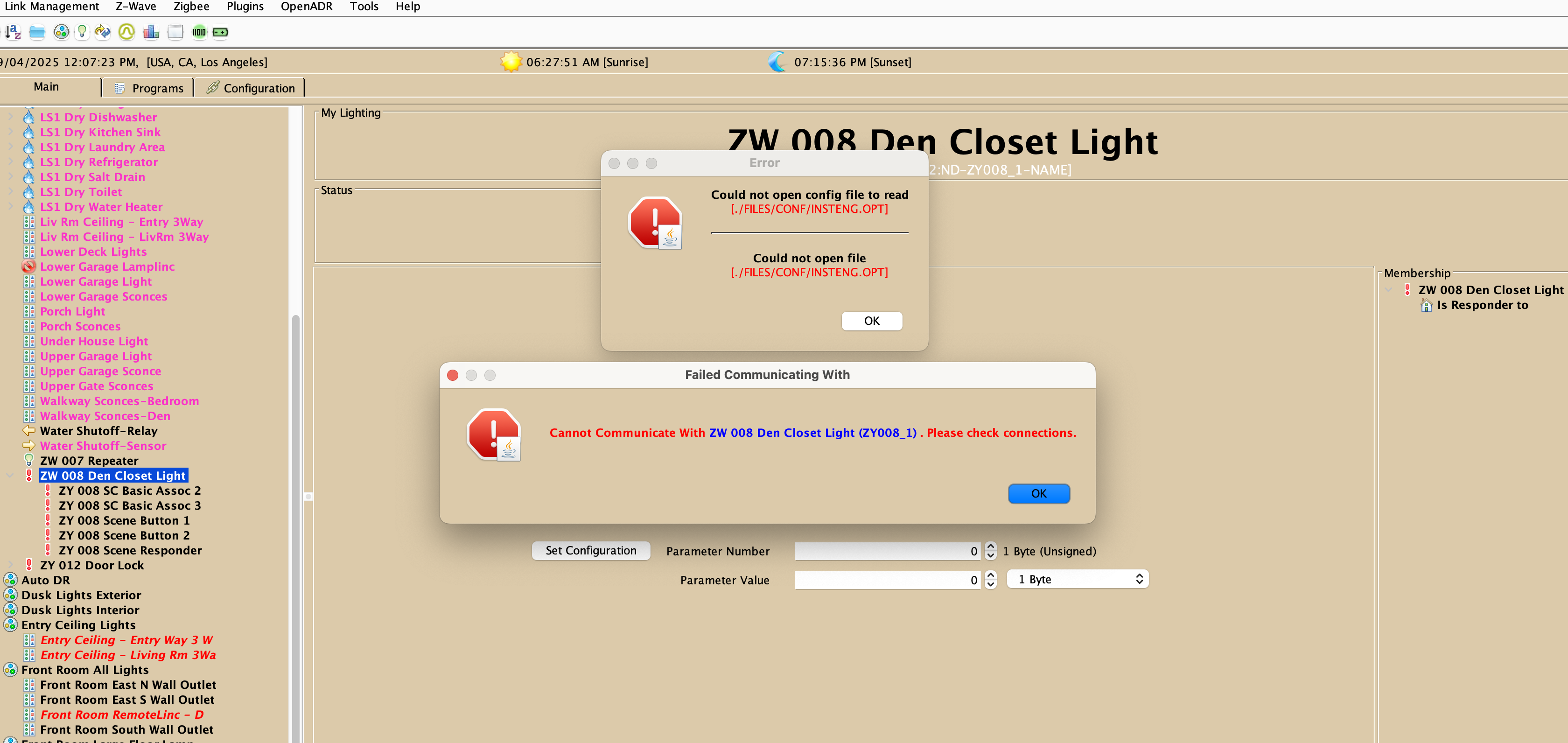

EGX Posted 22 hours ago Posted 22 hours ago After upgrading to 5.9.1 when trying to access a ZWAVE device I got the following error messages. Could not open conf file to read - [./FILES/CONF/INSTENG>OPT] Could not open file - [./FILES/CONF/INSTENG.OPT] All my insteon devices were working after the upgrade but not the ZWAVE. Quote

EGX Posted 16 hours ago Author Posted 16 hours ago I was upgrading from firmware 5.8.4 The dongle I am using was purchased from UD Mobil which has two antennae. One is labeled Zwave and the other is labeled Zigbee/Matter. Quote
Guy Lavoie Posted 3 hours ago Posted 3 hours ago 12 hours ago, EGX said: I was upgrading from firmware 5.8.4 The dongle I am using was purchased from UD Mobil which has two antennae. One is labeled Zwave and the other is labeled Zigbee/Matter. So nothing out of the ordinary. You have the ZMatter dongle. One quick thing you could check is in the Admin Console Configuration screen. Make sure that Z-Wave support is "On", and that it's not showing a button underneath to migrate to ZMatter, which would indicate it's configured to use the Zooz dongle. Quote
