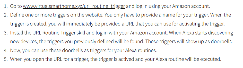

This is from the virtualsmarthome.xyz website:
Since you have an URL, I'm assuming that you've completed steps 1 & 2, but have you also done steps 3 & 4?  I have absolutely no experience with Alexa skills, nor virtualsmarthome.xyz, so I'm just shooting in the dark in case any of this triggers (all puns intended) something in your mind.
