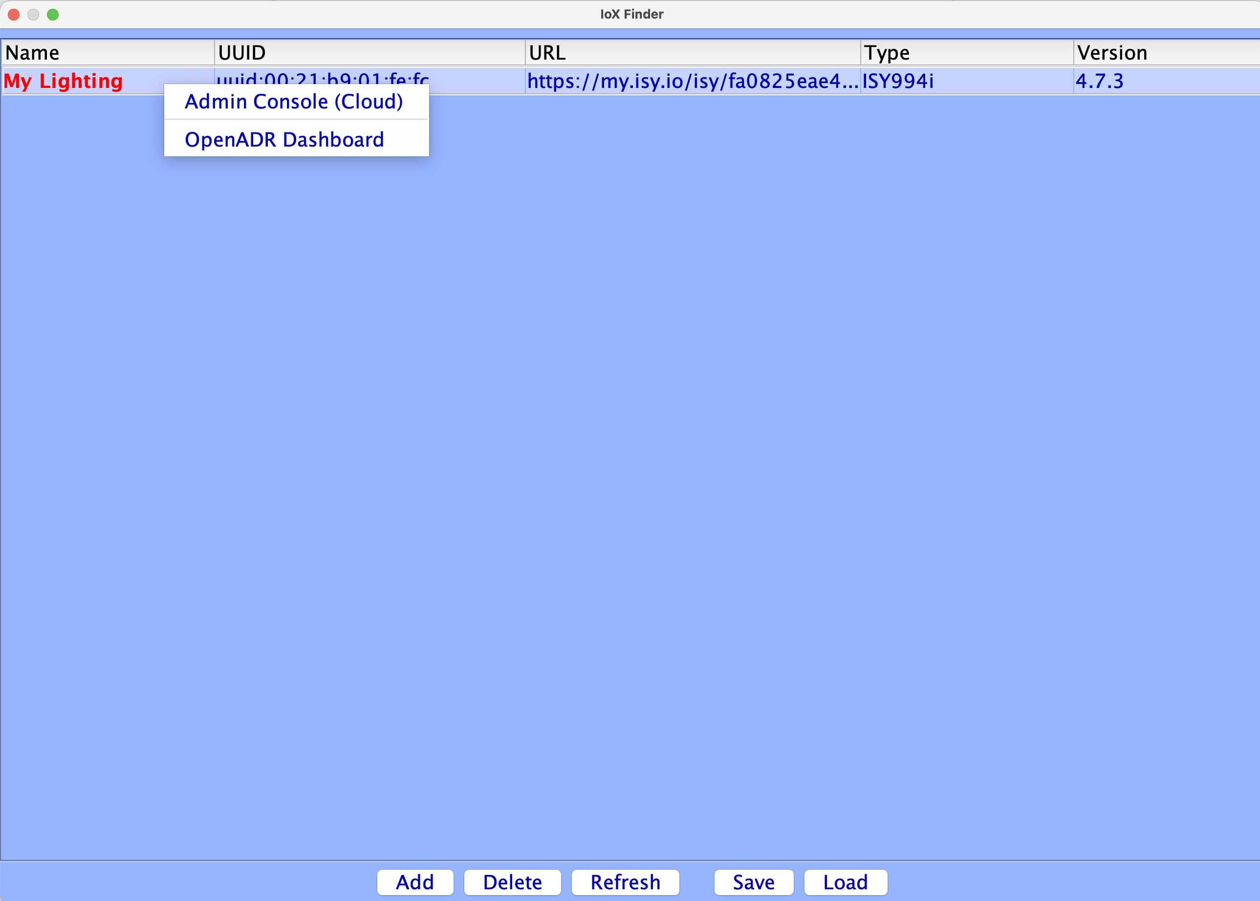

I had a power surge/failure destroy my serial modem so I replaced it. I know my ISY994i is alive and kicking since I can access it via the ISY Portal's ISY Web Access, operate lights and so on. I have long used the Admin Console on my Mac, but when I use it now (see photo) it doesn't pull the LAN based access to it automatically. I added the Admin Console URL manually on the IoX Launcher, audit shows up as Cloud access, but when the "Authenticate My Lighting" dialog box comes up, my login credentials don't work. I tried the default admin-admin and no go. Certainly didn't change the password, but at any rate I know it's operating inside that black box because it works through the Web Access.

@mvgossman based on your screen shot you're using the ISY Portal address for your device. You'll need to use your portal credentials to log into admin console.
