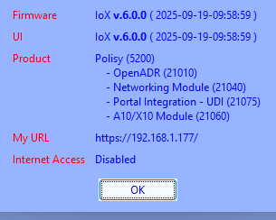

It appears i just succeeded.  I figured out how to expand the partition to use the full ssd drive.  I then rebooted it, ran the update and about 20 minutes later it rebooted to the new firmware.

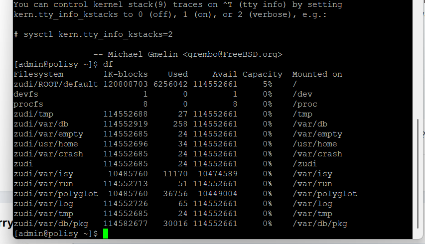

Could you post an image of your screen following a "df" comnand from the unix shell?
Looks like I am using 6GB of ssd space.  With the partition previously being 3GB, that could be an issue.
Cool! Nice to have the tools to expand existing filesystems.
