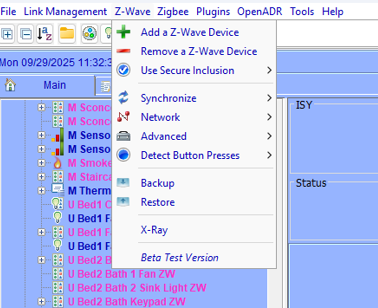

@jkmcfadden - Yes, I do not have those options in my menu.  This is what mine looks like:
I wonder if it is now automatically included in the normal backup with the newer version.  It is annoying to have to remember to do it because it apparently becomes embedded in the normal backup anyway.  UD Support should be able to answer.
