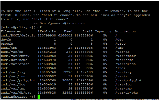

Fastest way to fix this is to order an mSSD card adapter for USB from Amazon and UD can hook you up with a download of the image file and you can re-flash the image onto the mSSD then restore your backup.  Hopefully you have a backup.  The only issue I ran into doing that is the flashed image only paritioned 3GB of space on the mSSD which was too small to do upgrades.  I had to SSH into my Polisy and execute some commands to increase the partition size to fill the entire SSD.  I did this a couple days ago and posted a video telling you how.  After I enlarged the partition I did the upgrade to 6.0.0 and it worked perfectly.
This is the one I got.  I assume Eisy uses the same style ssd as Polisy.

I would recommend checking your file system to make sure the image didn't flash a 3GB partition.  SSH into eisy and execute the command df  and it will show you your SSD memory situation.
