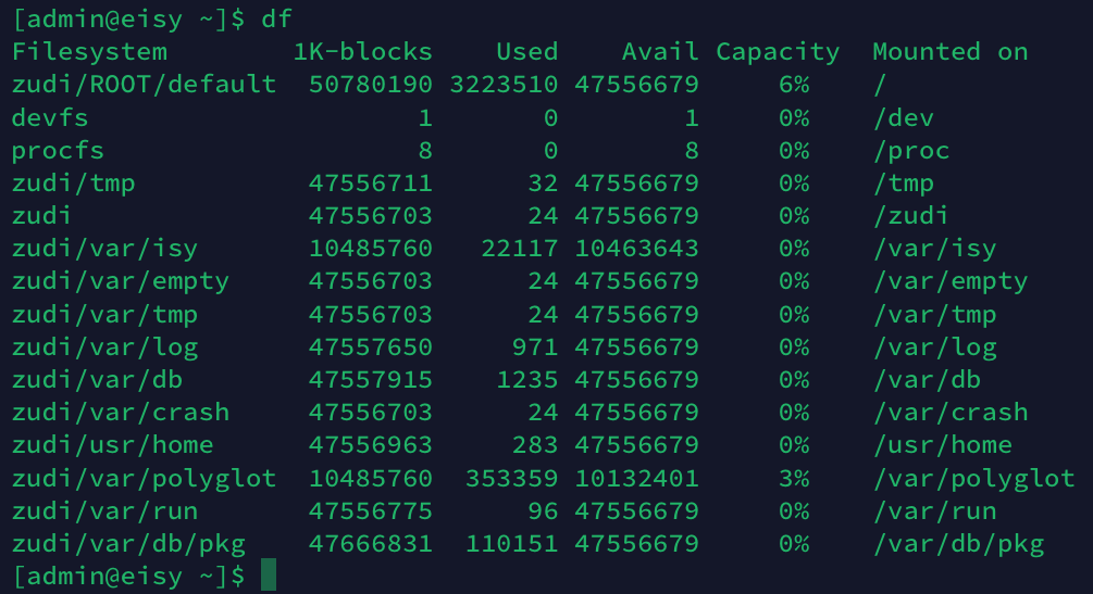

I'm preparing to upgrade my eisy to 6.0 / eisy-ui in the near future. I've been following others progress from afar. I think the disk space issue and using the df command were related to policy. I sifted through some of the threads but not 100% sure and want to be sure before proceeding. My command line days are getting more behind me and have no time logged on FreeBSD.
I was able to ssh in and run df. Here are the results. I should not run into space issues?
Looks like you are using roughly 3gb out of 50 total.  50 is a bit of a weird number, maybe it is a 64gb drive and they aren't using all of it?
But like Guy said, I wouldn't worry about it.  I doubt you will ever need more than 50gb.
I believe if you follow the guy on the youtube video posted through the zpool list command it will tell you how big your drive is and how much of it is unallocated.
