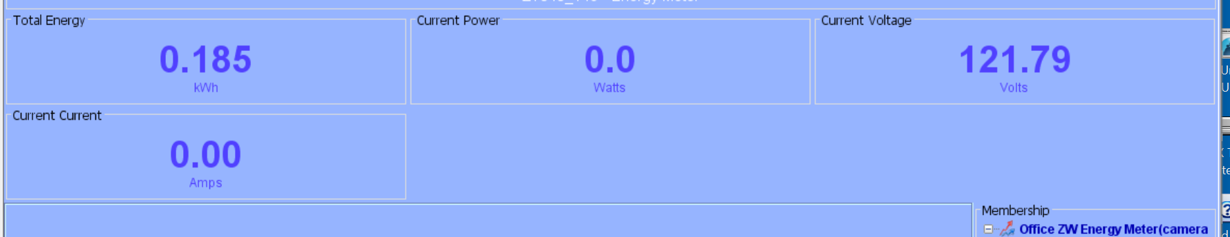

The smart plug displays  current power, etc. You can use one of those parameters to trigger a program.  The only downside is it can only report every minute so there could be a delay
Watt Report Threshold
Parameter 5: Choose how you want your Smart Plug to report power consumption to your hub. The number entered as value corresponds to the number of Watts the appliance needs to go over for the change to be reported. So if 5 Watts are entered by default, the Smart Plug will report any change in power usage over 5 Watts (whether it’s at least 5 Watts more or 5 Watts less compared to the previous report).
Values for 700 series: 5 – 50. Default: 5.
Values for 800 series: 0 - disabled; 1-100. Default: 5.
Size: 1 byte dec
Watt Report Frequency
Parameter 6: The number entered as value corresponds to the number of minutes. So if 5 is entered by default, the Smart Plug will report power consumption (Wattage) every 5 minutes.
Values: 1 – 65535. Default: 5 (minutes).
Size: 4 bytes dec
You would use a program to trigger whatever you're trying to turn on or off, i.e.
IF
    Status Switch energy current > .1 amp
Then
    Do whatever
Else
@matapan
I just created a test program using the Zooz ZEN04. It triggered a program when the current draw exceeded .1 amp.
So it should be an easy replacement for the Synchronic.
