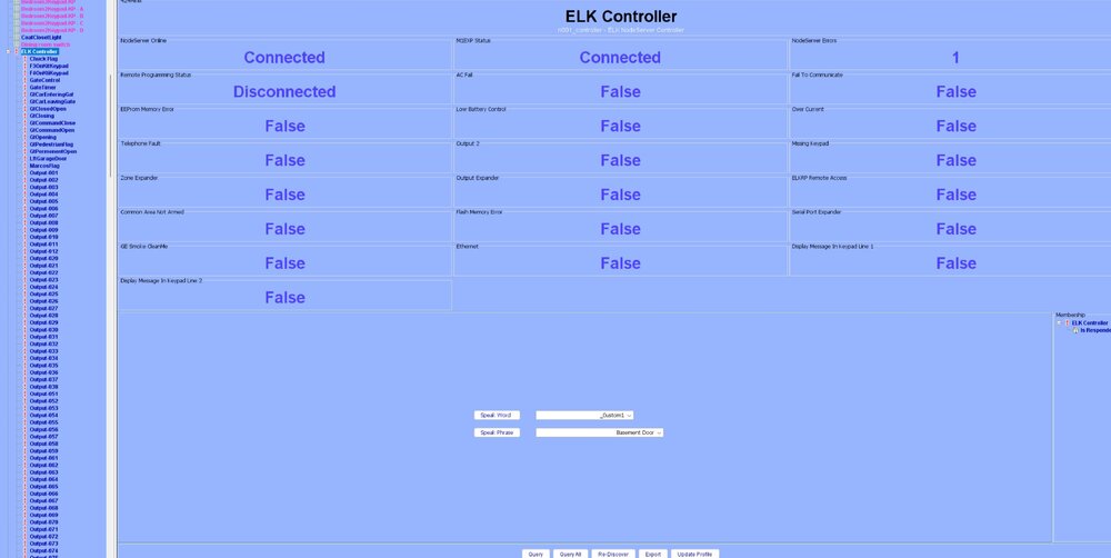

October 16, 2025Oct 16 @srjacob FYI - removed the .zip file you added and just put the image and log file. Usually better not to use .zip files unless they're huge. Not many will download .zip files for risk of threats inside them. Images are fine to upload as an image and .log files are fine to upload. Typically the exclamation points means IoX is not able to communicate with the device. Close admin console and make sure the plugin is setup correctly. Check in the plugin (web access) that the nodes are found and correct. Maybe restart the plugin. Then re-open admin console and see if the problem is corrected.Remember if you have admin console open and you change something in the plugin you must always restart the admin console for most changes to be read. That's why it's often suggested not to have both open at the same time. Lastly, please include what device and firmware (actual version number) you're using. It might also help to include the plugin version number. Be sure to give actual numbers and not just say "current firmware/plugin" as that's not helpful months down the road if somebody finds this post and thinks they have a similar issue, but firmware or plugin versions might have changed.
October 21, 2025Oct 21 The red exclamations are because as shown on your screen "Node Server Errors" = 1. The debug.log doesn't show the error since it rolls over each night. Is there an error shown on the PG3x Page for this plugin?
October 23, 2025Oct 23 Author Where exactly do I find "Node Server Errors"? If I do find it (if you tell me where it is), what do I change it too?Where do I find errors on the PG3x page? I did a screenshot of the pg3x page, and have attached it.

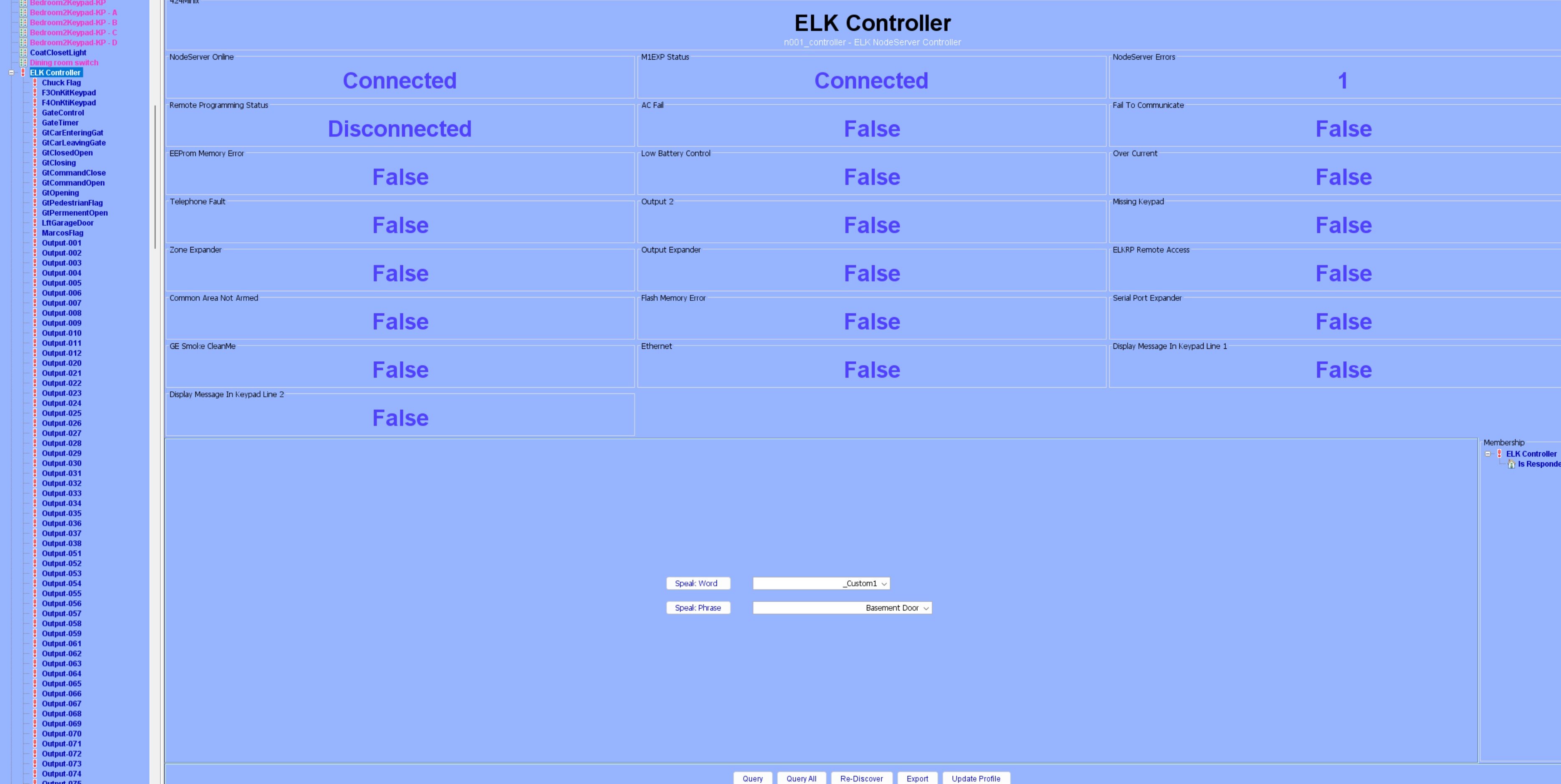

October 26, 2025Oct 26 I don't think this will fix it, but please try this:Open Admin Console with IoX Launcher and loginClick "Configuration" TabClick "Netowrking" TabClick "Network Resources" TabClick "Add" button at bottomHit Enter to accept Name as Name.1Click the "- Select to Edit Content -" in the URL ColumnIn the new window enter "somehost" for the HostClick "Save"So you'll have thisThen restart the plugin for the PG3x UI, and if the errors still show go to the Log for the ELK Plugin and "Download Log Package" and PM that to me.
October 26, 2025Oct 26 For some reason it won't let me edit my post above.After the last "Save", also hit "Save" at the bottom of the window.21 hours ago, SJacobson said:More log files. There are NO error logs.There are NO error logs, the errors were in the debug.log.
October 26, 2025Oct 26 2 hours ago, Jimbo.Automates said:I don't think this will fix it, but please try this:Open Admin Console with IoX Launcher and loginClick "Configuration" TabClick "Netowrking" TabClick "Network Resources" TabClick "Add" button at bottomHit Enter to accept Name as Name.1Click the "- Select to Edit Content -" in the URL ColumnIn the new window enter "somehost" for the HostClick "Save"So you'll have thisThen restart the plugin for the PG3x UI, and if the errors still show go to the Log for the ELK Plugin and "Download Log Package" and PM that to me.2 hours ago, Jimbo.Automates said:I don't think this will fix it, but please try this:Open Admin Console with IoX Launcher and loginClick "Configuration" TabClick "Netowrking" TabClick "Network Resources" TabClick "Add" button at bottomHit Enter to accept Name as Name.1Click the "- Select to Edit Content -" in the URL ColumnIn the new window enter "somehost" for the HostClick "Save"So you'll have thisThen restart the plugin for the PG3x UI, and if the errors still show go to the Log for the ELK Plugin and "Download Log Package" and PM that to me.The red arrows changed to left pointing arrows. See uploaded image.
October 26, 2025Oct 26 So that did fix it. It was a bug in a shared library PyISY that we use. Your welcome.
