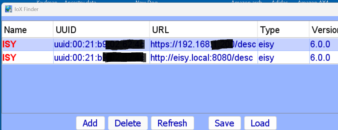

You can add the attached URL entry to the admin login which will bypass eisy ui and use your previous (local) login info

The new login in method is an option (makes going between admin console, PG3 and portal seamless). You can continue logging in using the previous way too, as long as the URL contains the port number (8443) as it always has. Good ole "admin" and your IoX password.

In the IoX Launcher window, click on ADD, then enter the URL info on the 2nd line, then click on Save.
This will create an additional entry in the IoX Launcher for local access using your previous login credentials. The login window will either ask you for your ISY login info or your portal login info dependinng on which line you click on
