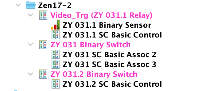

I discovered that if I didn't set Parameters 2 and 3 to 10 (on/off report -dry contact switch/sensor) and then remove (aka exclude) and add (aka include) the relay, the input node for the binary sensor never appears on the console. Once I do that, I can get the first binary sensor node to appear, but never the second one. In the screenshot below, ZY 031.1 Binary Sensor appears, but not ZY 031.2 Binary Sensor. I've attempted to set Parameter 3 ten times on two different Zen17 Relays, and I always get the result you see below.

Adding insult to injury, I've been able to use the Status of ZY 031.1 Binary Sensor if I connect S1/C to a dry contact sensor (actually a spare toggle switch for testing). However, when I connect V1/C to a 12V DC sensor, I receive no response in my logic. And my sensor sends 12 VDC when true, so that is what I need. I thought that there might be another Parameter I need to set, but so far, I haven't found it.
