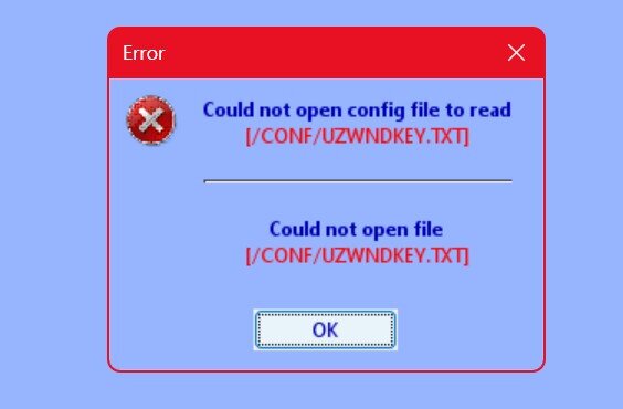

I have two ISY994s and and eisy. One ISY has the Elk module and controls (through the Elk) an electronic gate (via an M1KAM moduole). The ISY and the Elk module words great and very reliable. I decided I needed a backup to the ISY and Elk module, and purchased an eisy and got the Elk plugin. Since trying to migrate, I have encountered numerous problems, particularly with the Elk plugin. I am only keeping the ISY as a spare, since I am highly dependent on the gate and the Elk alarm (I have spare boards for these). Anyway, I took the SD card from the ISY and saved an image to the hard disk on my computer (using Macrium Reflect). I then wrote that image to a micro SD card (also using Macrium Reflect, and plugged it in to the ISY, and rebooted the ISY, and the control panel came up and it looks like all the Insteon devices are there, and the Elk module is there also, but my programs aren't there. I tried to restore the ISY from a recent backup (the same one that I loaded into the eisy), and the Insteon devices were there and the proper configuration was there, but the programs were not-the programs were missing. When the ISY restore tried to load the programs, I got the attached error (screenshot).
How do I fix this error, and get my programs to come up?

Anyway, I am just trying to find out why my programs disappeared on my working ISY. I suspect it is because of the write error (as shown in the attachment). If I could somehow telnet into the ISY, I could probably figure out the problem, but I can't seem too, unless some kind soul tells me how. UD simply won't help me.

I backed up the SD card using Macrium Reflect (because I don't have a backup to this ISY994 and I don't know how long this SD card will last). I then wrote the backed up sd card to another sd card, and put it IN THE SAME ISY994. All my programs disappeared. I then restored the configuration of the SAME ISY.

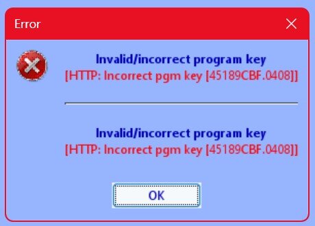

I tried to create a program to access the Elk, and when I tried to save it, I got the attached error message.
Does anyone know what this means?
