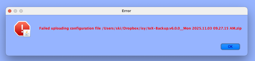

I'm a long time isy99ir, isy994ir, and now eisy user. I've upgraded to v6.0.0 without any issues. I was updating and replacing some failed insteon switches and for some reason, I can no longer restore from a backup. Logs say that the backup(s) were successful, but this is output of error log:
fileLength=481522 byteOffset=481045 tailLines=250000 resultLines=6 resultByteSize=412
Mon 2025/11/03 09:32:49 AM 0 -170001 <s:Envelope><s:Body><u:GetSystemStatus xmlns:u="urn:udi-com:service:X_IoX_Service:1"></u:GetSystemStatus></s:Body></s:Envelope>
Mon 2025/11/03 09:32:50 AM 0 -170001 [HTTP:8-57] Closing socket normally
Mon 2025/11/03 09:33:05 AM 0 -170001 [HTTP:7-57] �Z�H
Mon 2025/11/03 09:33:05 AM 0 -170001 [HTTP:7-57]: GET-->/rest/log/xray?path=ERROR.LOG&tail=250000&max=25000

Michel responded quickly and suggested running Upgrade Packages again. That did the trick, I can now restore from backup. Thank you.
