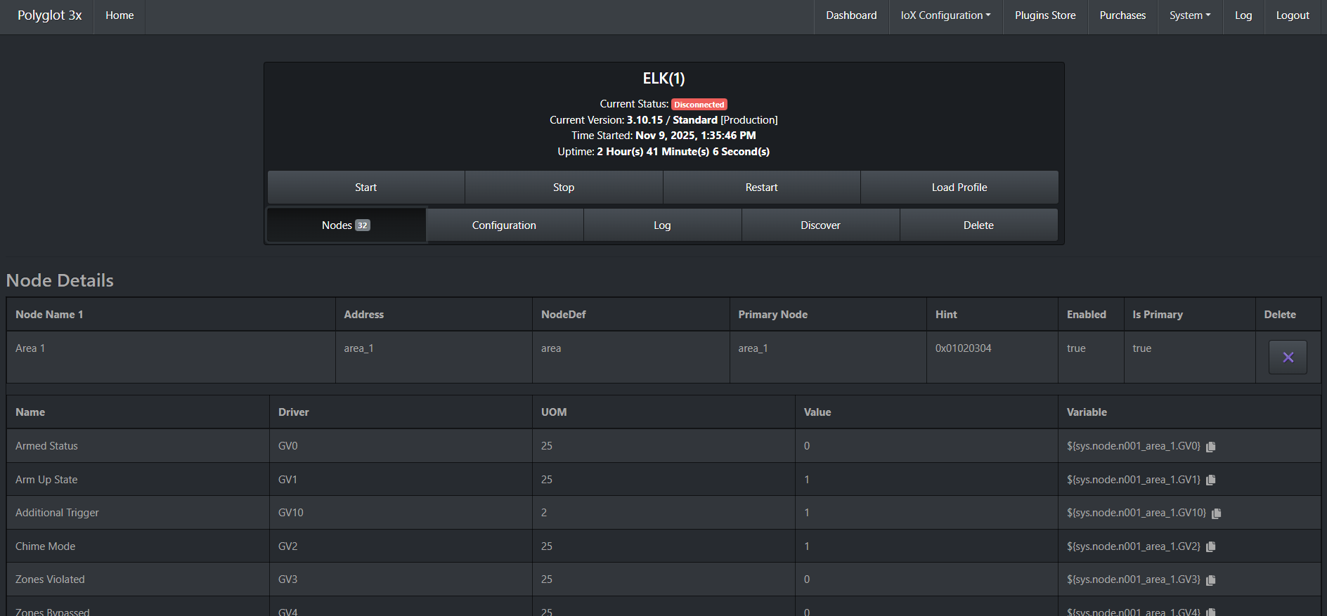

Elk is working fine, all nodes are there, but all fields in Administrative Console are blank. I'm using portal password to log into Eisy instructed. Does Polyglot require this also? If so, how do I go about changing it? What else should I be looking at to make this work?

I experienced the Elk plugin being disconnected after updating to IoX 6.0. I tried restarting the plugin several times but nothing I tried would work.
I then tried reinstalling the plugin. I had to do the reinstall 2 times, but did manage to get it connected and working again.
Fifth reinstall did the trick! Thanks for your help!
