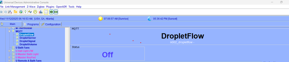

So I have made some progress.
Using the following yaml file, I can now get all 4 "devices" to show up in the admin window. But all they do is to execute the same "state" command.
devices:
- id: "DropletFlow"
type: "sensor"
sensor_id: "Droplet-AE50"
status_topic: "droplet-AE50/state"
value_template: "{{ value_json.flow }}"
cmd_topic: "droplet-AE50/cmd"
- id: "DropletVolume"
type: "sensor"
value_template: "{{ value_json.volume }}"
- id: "DropletSignal"
type: "sensor"
value_template: "{{ value_json.signal }}"
- id: "DropletServer"
type: "sensor"
value_template: "{{ value_json.server }}"
Note - I have the "value_template" option in the yaml after some discussion with the Droplet support bot. It does not seem to hurt so I have left it for now. And the "Status" value in the admin console is just a phantom leftover of whatever I clicked on last.
What my issue is (I think) is that the Droplet has just a single "state" command that returns all the values. Droplet does not have individual state requests for each value.
Payload = {"server":"Connected","signal":"Strong Signal","volume":-23.06,"flow":0.00}, Topic = droplet-AE50/state
So my question seems to be, how do I get the parsed value out of the state request to associate with the entity? The value_template appears to be how it is handled in the Home Assistant variation of this interface. Is there a different type I should be using?

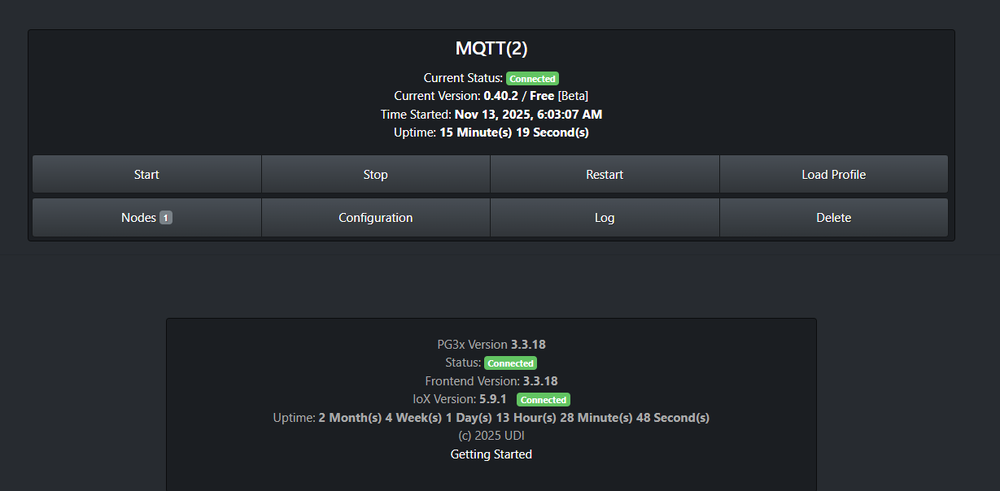

Hi @sjenkins and @TriLife I have installed the beta MQTT and updated to the settings listed above. FYI - I did delete the production version of MQTT since I have no other MQTT devices and I wanted to make sure I was using the correct version.
Here is my yaml file:
devices:
- id: "DropletH"
type: "droplet"
status_topic: "droplet-AE50"
cmd_topic: "droplet-AE50"
But I am getting this message in the log file.
2025-11-13 06:03:08.663 Thread-3 (parameterHandler) udi_interface ERROR Controller:discover_nodes: Device type droplet is not yet supported
I have attached the full log file that was created after my most recent "restart".
Did I maybe miss a step?
Would you like me to continue to use this thread - or use the "generic" one you created for the beta release?
debug.log
Edited by jkmcfadden

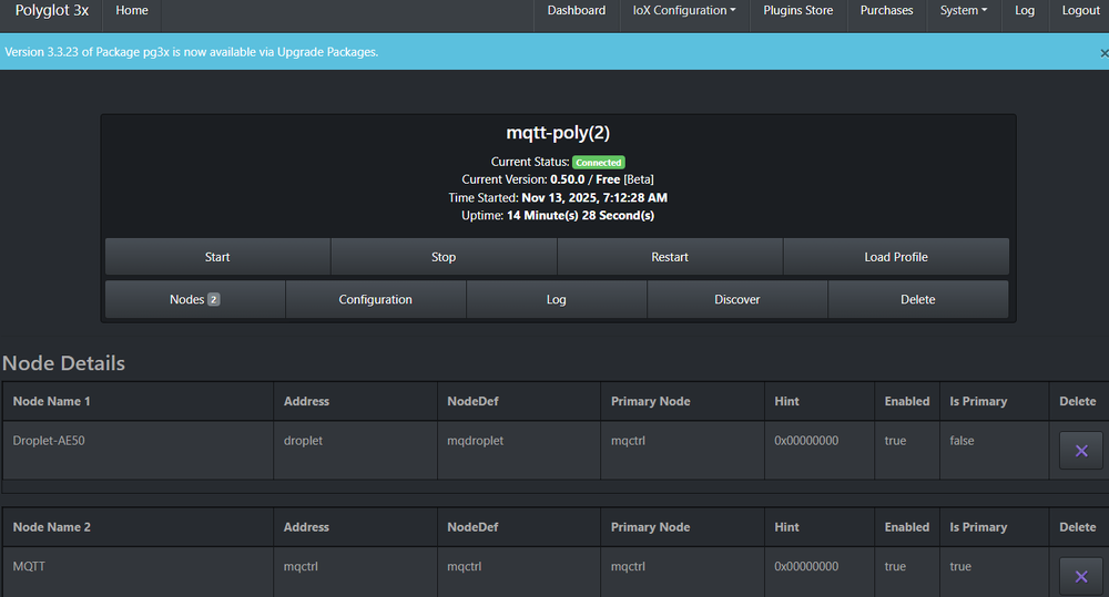

Hi @jkmcfadden ,
You installed the regular mqtt plugin. Go to the non-production store and scroll right to the bottom and install mqtt-poly
It will be version 0.50.0
Edited by sjenkins
@sjenkins I was hoping it was something stupid like that - the one I had said "beta" so I assumed it was correct. I am re-installing now. Thanks!

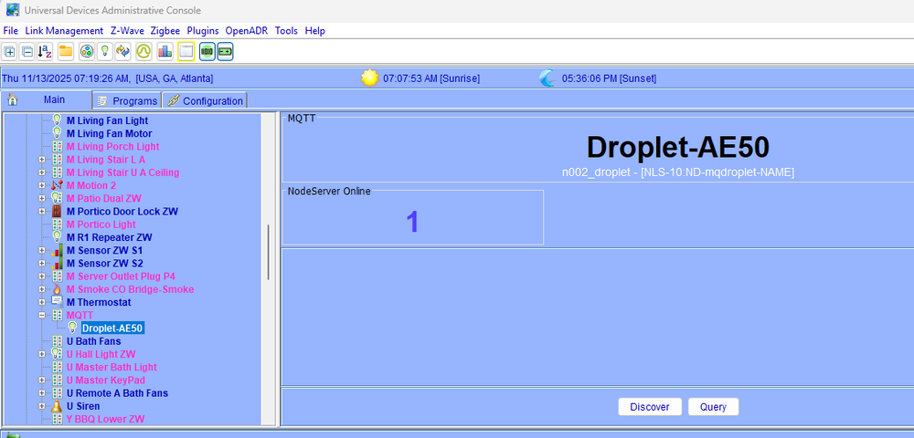

@sjenkins Some progress
Here is my yaml entry:
devices:
- id: "Droplet"
type: "droplet"
But still not getting the fully configured entry in the admin console.
I can see the health and state calls and replies. Log attached.
Unfortunately, I have to go to my day job - so replies might be sporadic. To be honest, this is way more fun but I gotta pay the bills 😉

@jkmcfadden ,
Do an ISY reboot for me.
Since eisy-ui came along this is sometimes required on many plugins
Actually if you log onto the local AC it will likely all be there.
The logs look healthy.
@jkmcfadden ,
Ok!! Enjoy and test the crap out of it.
Make a few programs but remember when we goto production those programs will require touching up. Has to do with having different id number to the regular plugin.
Can’t think of any improvement path but let me know as you use it.
@sjenkins
Just created and ran a test program to alert me when the flow exceeds a certain level. Works like a charm! It is exactly what I wanted to do with this device. Basically to get notified on flow when there should not be - AKA a "leak".
Thanks for your patience with me, your hard work and quick turn-around.
Kelly
@sjenkins
My testing is going well. This is the yaml I am currently using.
devices:
- id: "Droplet"
type: "droplet"
Couple of questions:
1) I have a second droplet on order. How would the entry of the second one look? Sould all the values be different except the "type". For instance:
devices:
- id: "Droplet2"
type: "droplet"
status_topic: "droplet-XX00"
cmd_topic: "droplet-XX00"
I sort of remember I tried using the following in my original configuration and it did not work with anything except "Droplet" as the "id:" - sorry I don't have the exact log messages anymore, I just know I had to change the "id:" to "Droplet" to get it to work. I sort of remember a message about "DropletH" not found (or something like that).
devices:
- id: "DropletH"
type: "droplet"
2) To then add the new "Droplet", once I update the yaml, do I just restart MQTT in the PolyGlot dashboard to get it to appear in the Console? Or is there a cleaner way?
Again - thanks for your patience with me while I learn this new interface.
Kelly
@jkmcfadden ,
the id can be almost anything, droplet1, stephen, droplet2, it gets turned into the address of the node with a function to make sure its unique and short enough. The type must be "droplet". The name must be < 30 chars and also can be anything, kitchen, livingroom etc.
Let me know if you see behaviour different than this.
