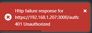

I haven't attempted to log into Polyglot 3x for a while. When I attempted to do so tonight, I received the following response:
I'll confess that I'm far from being an EISY power user, and I tend to use the beast in a similar manner as the ISY 994i that it replaced.
I attempted to log into PG3 through the Admin console, using the Plugins>Launch Polyglot V3 (PG3) dropdown menu with the same username and password that I use to log into the admin console. This had always worked for me previously, but it appears that something has changed.
I haven't been actively browsing the forum much recently, but I am aware that the Admin Console is in the process of being gradually replaced by a browser based utility. Not sure if this might be responsible for the difficulties I'm having here?

It's running 6.0.0. I am using my portal credentials to successfully log into the admin console, but they're not working for PG3 login. Tried the admin/admin suggestion, but that doesn't work either.
UPDATE:
With the EISY 6.0.0 migration, Admin console logins were migrated to use your portal credentials. I assumed that this applied to PG3 logins as well.
My PG3 login appears to have RETAINED its original credentials (i.e. my pre EISY 6.0.0. admin console login credentials). I was finally able to successfully log into PG3 by using my old Admin console username and password.
