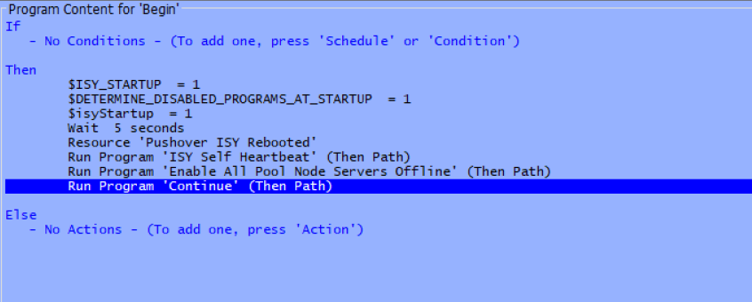

Is anyone else seeing issues with programs that are supposed to run at startup? I have one that executes as it should and does notify me that the IoX has finished rebooting but after that I make it wait 15 minutes before it starts executing most things. There is a 15 min wait and then it calls another program which sets a variable the allows execution. This worked fine until 6.0.3. Now it must be stopping in the 15 min wait somewhere. Thanks for any help.
@btreinders For future reference posting programs please right click the program and select "Copy to Clipboard" then you can post as text in your reply. It's helpful for anybody trying to support your program as they can edit and change things a lot easier. Rather than describing what to change and where to put it. The "Copy to clipboard" option copies the TEXT of the program and makes it easy to post in the forums and thus easy to edit as well as makes your situation searchable in case others have similar issues in the future.
