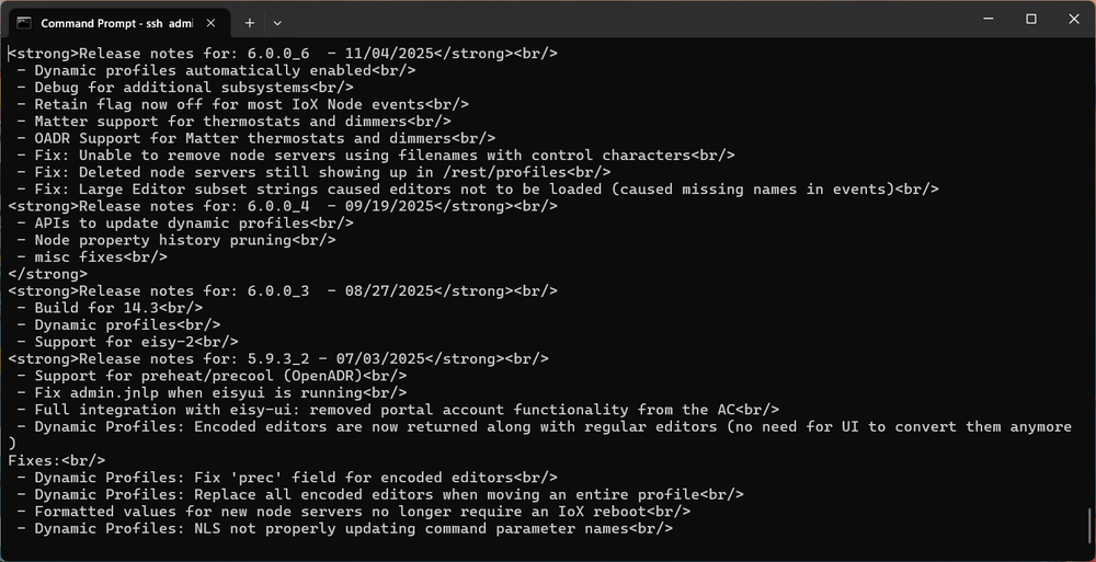

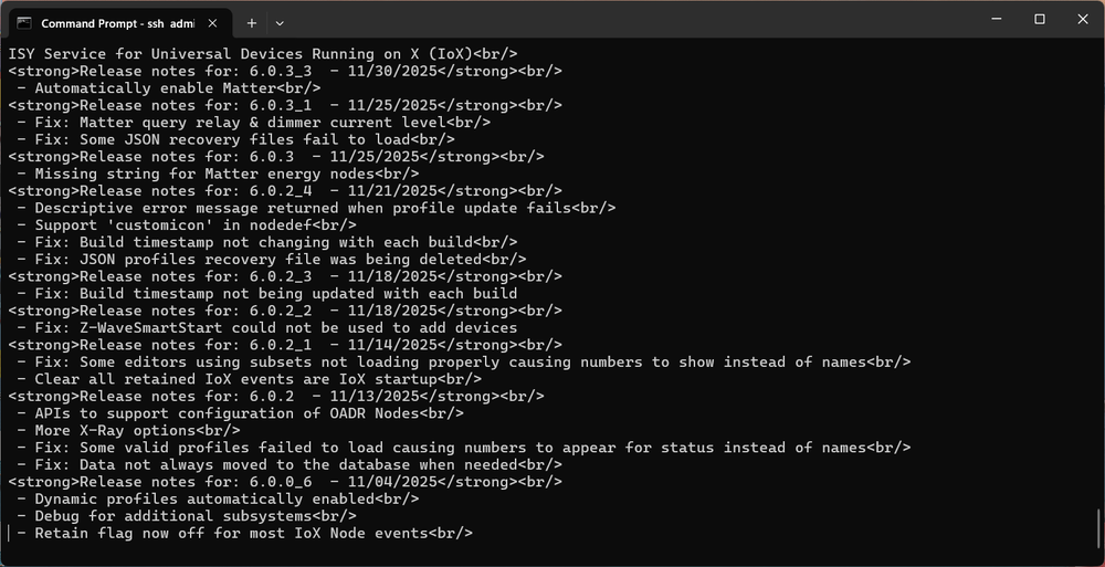

UDI hasn't said anything about what's new in 6.0.3, but here are the change descriptions in the sysconfig.txt file:
