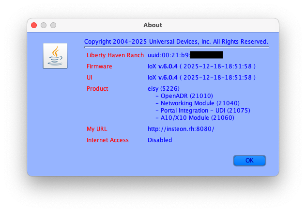

Update finished, ended up at 6.0.4. Updated Java Admin Console to match. Still don't seem to have docker anywhere inside. Do I need to "Install Dev Packages" or is that something entirely different?
I think that’s only for plugin developers. I’ve never run it. Have you already rebooted after the update?
@hart2hart It rebooted itself (wouldn't have noticed except it kicked my SSH window).Screenshot 2025-12-25 at 5.31.49 PM.png
Edited by lhranch
