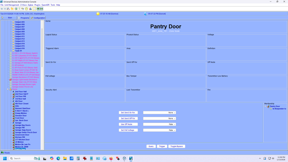

Looking at the Eisy, Main, where the Elks zones are displayed... I have a zone called pantry door. There isn't any status. If I open and close the door nothing changes. So none of my programs using Elk zones are working. If I look at the node(zone) in polygot I don't see any change of status. Only thing that changed is the ELK-M!xep was replaced. The M1XEP (old) had a static address. The new M1xep has a new address. On my old isy-99 I had a ELK tab I would go to to update the ipa of the ELK in the ISY. I am assuming the reason things are screwed up is the IPA. I can't find where to put the new IPA? I know I did it when I first went to the new eisy but can't remember. image.png
FIXED... Didn't scroll down polyglot config... DUH
