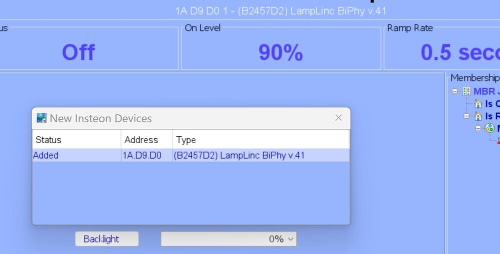

Why am I getting this "New Insteon Device" box?
Every time I open IoX I get this error alert box since v6.0.4 happened.
How do I stop this from happening?
This device was suddenly crashed a few weeks ago and I had to delete it and start from scratch adding it to my polisy and then re-include it in the Insteon scenes previously created.
I have Restored it several times but IoX just doesn't seem to know about it.
Solved by bgrubb1
Restart IoX from IoX did the trick.
Thanks guys!
All the rebooting and power cycling that went on when I changed my router and ISP seemed to have brought it on but I guess the last one forced v6.0.4 on my system and it wasn't a completely clean update process.
