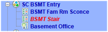

@scholarwarrior , what you are describing should work. I use something similar for my basement office that is controlled by a SWL Dimmer on the stairs.
  • The SWL dimmer is the controller for the scene BSMT Entry. When turned on scene members BSMT Fam Sconce and BSMT Office activate.
  • When I exit the basement I turn off the SWL dimmer which turns off the same two scene members.
  • The SWL OFF also triggers a program that turns off the BSMT Scene. The 3 second wait is to prevent collisions between the ISY and scene cleanup requests being sent by the SWL Dimmer.
BSMT Off - [ID 0009][Parent 0004]
