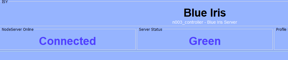

(Normal status shown below)
Here is the problem. For what ever reason "Server Status" or "Node Server Online" may change state to "Disconnected". This causes the triggers to stop working. Clicking "Re-Connect" on Blue Iris Plugin will fix either disruption. So I figured I would write a few programs.

There conditions besides "disconnected" that will be there when it is disconnected. Like "red". Anyway, use backward logic.

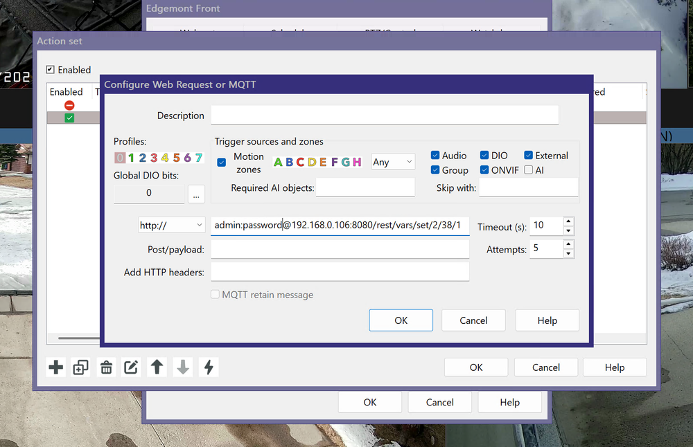

Regarding Triggers, I took a different approach.
I use BI Alerts to set a variable thru Rest on the EISY which triggers an Outdoor Lights Program. The program turns on the outdoor lights then Waits 5 minute then turns them off. Improved lighting helps BI recordings as I don't use IR, just ambient light. For example:
user:password@192.168.0.106:8080/rest/vars/set/2/38/1
I been using this combo for about 15 yrs and it works flawlessly, especially since BI's recent incorporation of AI.

@mmb I hate learning new stuff! It seems you are using BI to trigger EISY. We are using EISY to trigger BI. This is interesting. I have done some research and see that REST is an API. I think i figured this out. I was able to set a variable in EISY through a browser with this knowledge. I like this.
So now I assume:
192.168.0.106 is the EISY. (I thought it was BI)
/rest calls the API
/vars is the variable location on EISY
/set is to set a variable
/2 is state variable
/38 is your variable
/1 is the data
You assume correct, in BI select Settings / Alerts /On Alerts / + (lower left) then create new alert.
