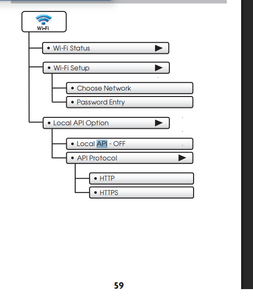

February 12Feb 12 There are settings way down in the stat menus for disabling/enabling the local api... my money's on that one.
February 12Feb 12 I have latest firmware on mine and use the skyport app and via the plugin. It’s been years since I set it up using nodelink and then migrating them to the Venstar Ct plugin but all I recall was having to authorize the local api. On thermostat it’s under WiFi enable local api. Probably can do it via skyport app too.
February 12Feb 12 Author @paulbates @hart2hartThe local api is enabled on both of them. It was off by default and I clicked to turn it on. There is a second line that is greyed out that says it is http.If local api were off, I'm not sure I would get anything when I go to the url. For exmple, if I do a sensor query I get this.{"sensors":[{"name":"Thermostat","temp":73.0},{"name":"Space Temp","temp":73.0}]} Edited February 12Feb 12 by apostolakisl

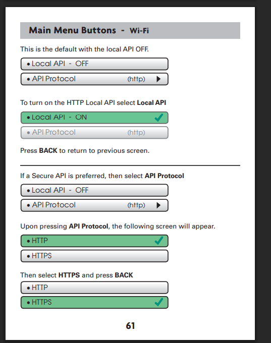

February 13Feb 13 Author Polisy isn't connected to wifi, it is hard wired, only the thermostats are connected to ssid's. They are all on the same corporate vlan. No firewalls between devices. From a pc on the same vlan I get responses from the IP address of the thermostats. The manual also shows that it has options to http vs https. But once you turn on api, it greyed out to http. Perhaps https could be selected first and then you turn on api?5 minutes ago, hart2hart said:I wasn’t suggesting your WiFi was not password protected. I was suggesting they might be connected to different SSIDs and one of the ssid was setup on its access point without choosing encryption in its setup.None of mine say http. Edited February 13Feb 13 by apostolakisl

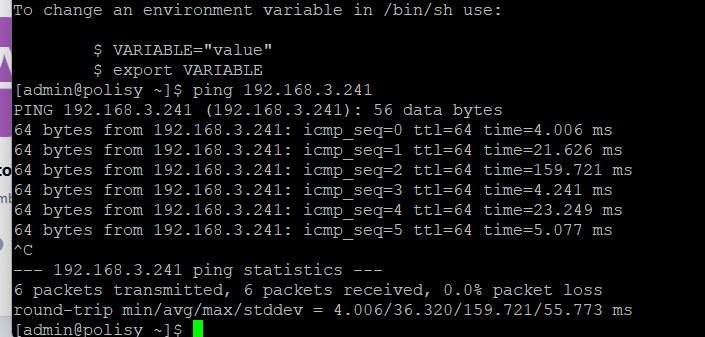

February 13Feb 13 Author 10 hours ago, hart2hart said:Can you ping the thermostats from the Polisy?yes, I can ping both of them. Mostly the response times are in the 5-10ms, though a few are much longer.EDITAnd I get a response on port 80. Not sure if I should check any other ports. Edited February 13Feb 13 by apostolakisl

February 13Feb 13 Author I changed the T7800 to https and set a username and password. Nodelink when set to http gave the error that the connection was refused. I changed to https and added the username and password and now the error is a timeout error. So it seems that the thermostat is accepting the https authorization but then ignoring whatever command nodelink is issuing to it. I can only assume that there is something going on with a firmware mismatch. Edited February 13Feb 13 by apostolakisl
