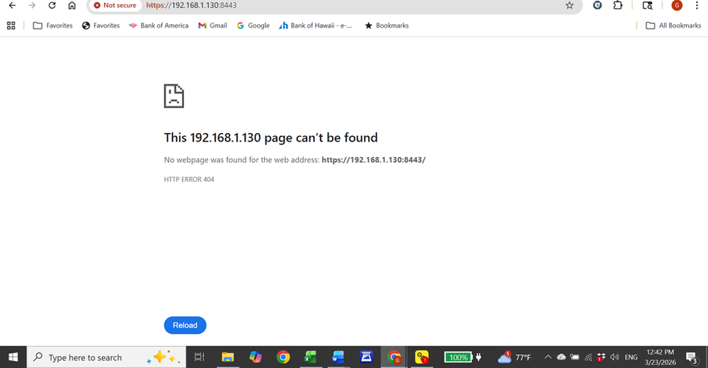

Greetings - just updated to version 6.0.5 which seemed to go smoothly but getting error trying to access PG3x: This page can't be found. Followed other posts: unplugged, reboot, upgrade packages, clear java cache. Tried executing from IoX finder, admin console, and UDI mobile. No joy..
What to try now?

If you are trying to access pg3x from a browser window, the port number is :3000, not :8443. However, accessing it with :3000, can cause some plugins to disconnect and reconnect.
As suggested, try https://eisy.local.

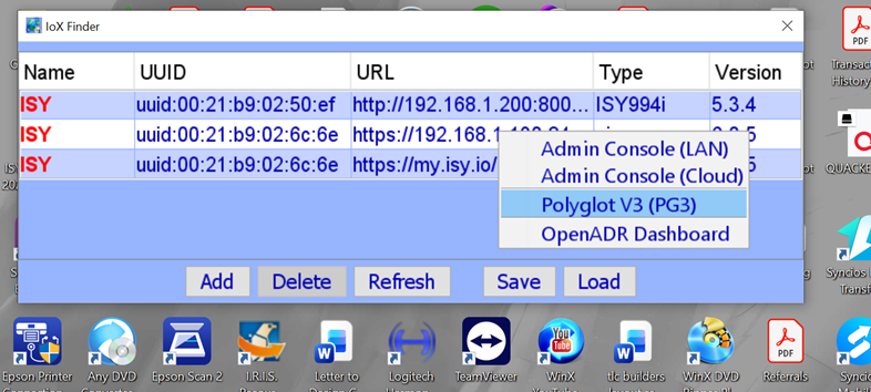

From the IoX Finder:

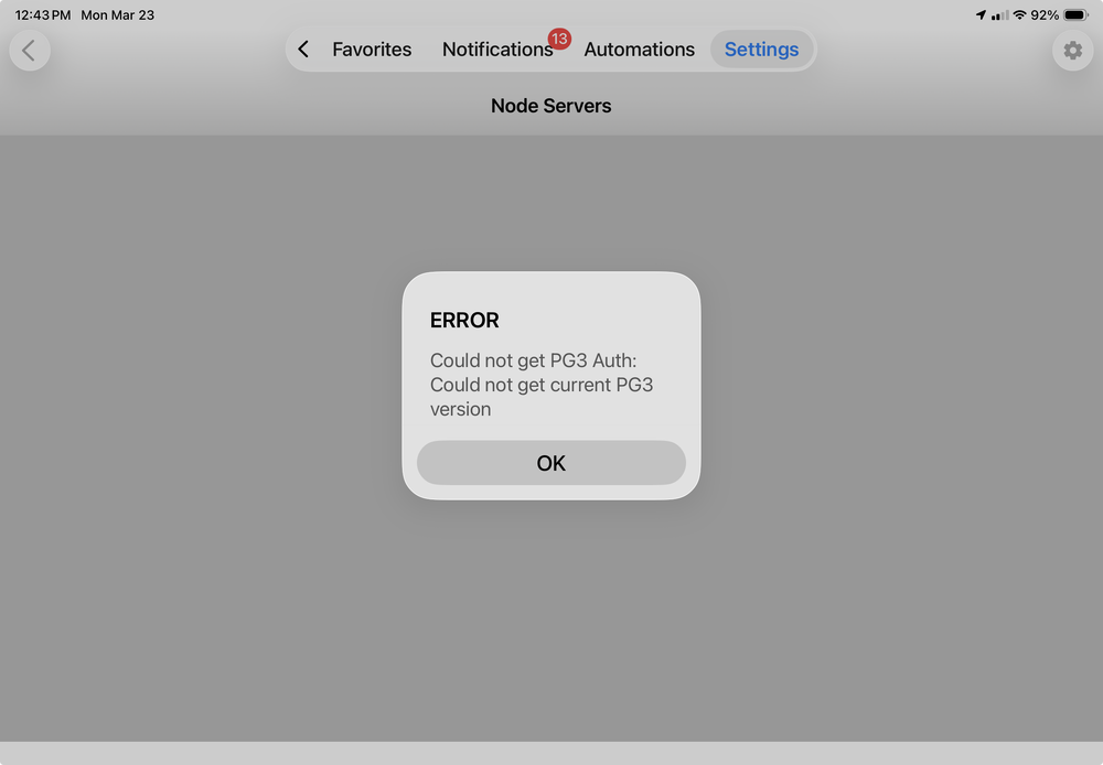

And from UDI Mobile
All with the same result

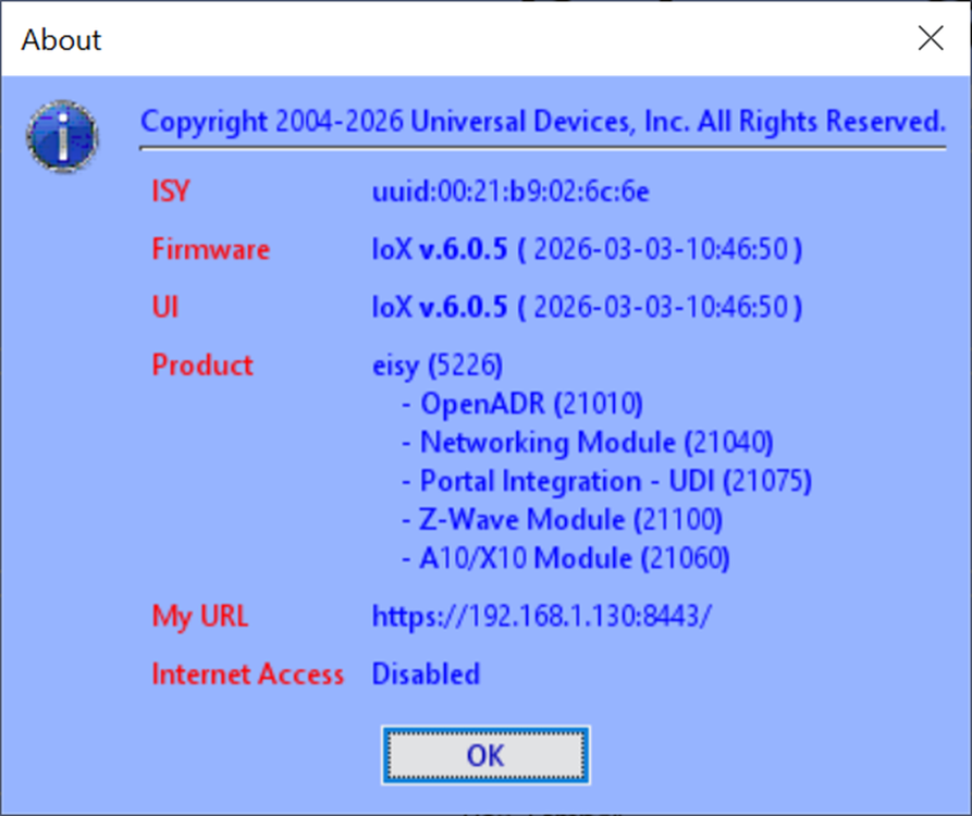

Not sure what you are showing in your screenshot labeled eisy.local, but your screenshot shows admin console, not eisy local.
