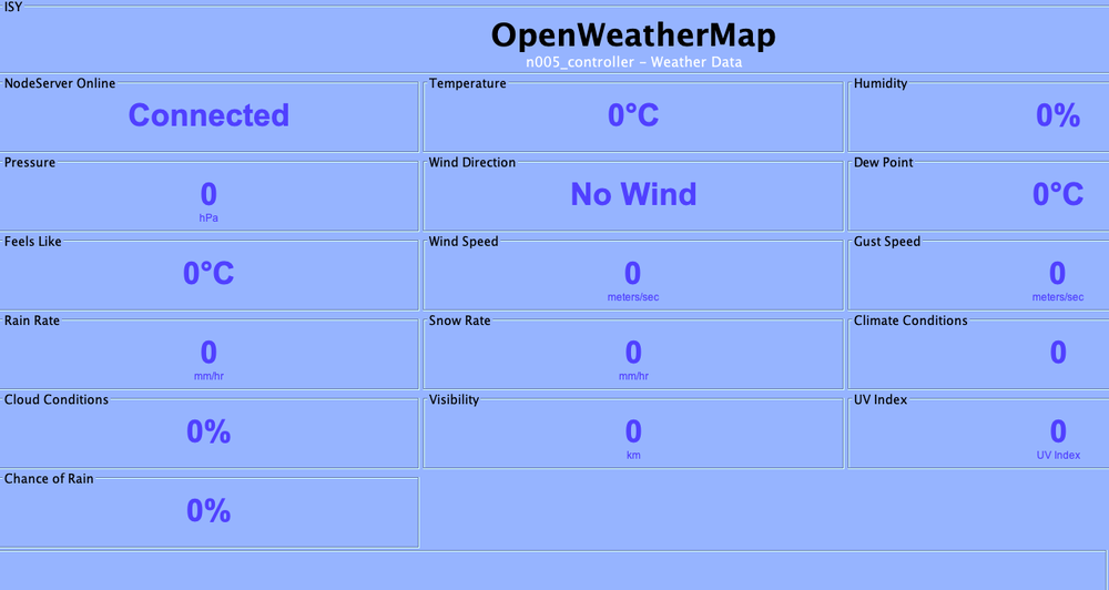

Can anyone direct me to more detailed information on getting either of these weather nodes working; I have them installed, but all I can see is zeros in the values. Screenshot 2026-05-21 at 3.29.58 PM.png

For Aeris you must have an Aeris account. The configuration help lists the information from your account that you need to enable the plug-in. However, it looks like they have been bought and are now https://www.xweather.com/docs/weather-api What that means for the plug-in, I don't know.
To access data from the OpenWeatherMap weather service you will need an account with openweathermap.org and a subscription to their weather service.
OpenWeatherMap has been problematic in that newly generated API keys don't always work or can take 24-48 hours to become active.
