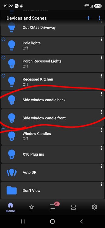

Couple hopefully small things... I got my 3 zwave devices added back and they work fine in the console and I synced mobile to console so they shoe up there but there's no way to control them. I normally could just tap the light bulb and my I stein switches turn on and off. Nothing happens here. Also On ud mobile it keeps saying z wave excluding in progress, z wave including in progress in a loop
A couple of things to try, reboot your mobile device and do a power cycle (remove power for 30 seconds on the eisy). You can also try deleting the UDMobile cache on your mobile device

I restarted my phone, did a power cycle on the eisy and also cleared the app cache and the excluding/including message went away but i still can't control any of the 3 z wave devices I added on the mobile device. If I hit the 3 dots and go to "configure" I get an error saying "could not get node. 500" (not sure if that's relevant.
Huh, I just forced a "synchronize" in the ud mobile app (which I had done before) and now it looks like it's working. Wondering if it need the cache cleared and THEN the sync to sort itself out.

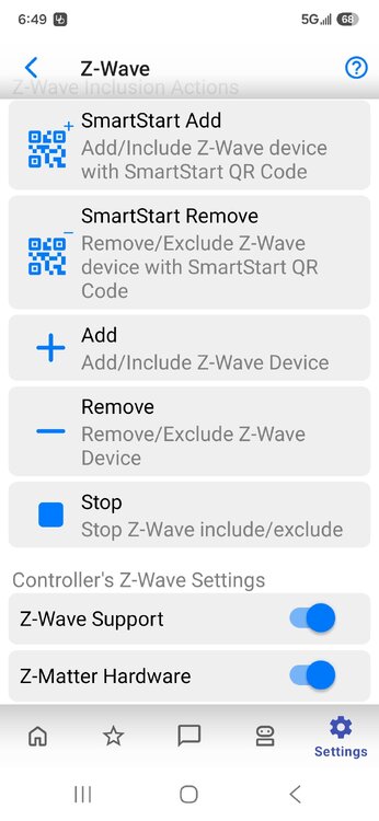

2 minutes ago, Techman said:
In UDmobile, under the Zwave menu, make sure Zwave Support is enabled and Matter Hardware is disabled.
If you're still having an issue then it's best to open a support ticket
yep it's enabled with matter disabled so that's ok. Interesting I don't have the two smart start options you do, which likely doesn't matter either.
