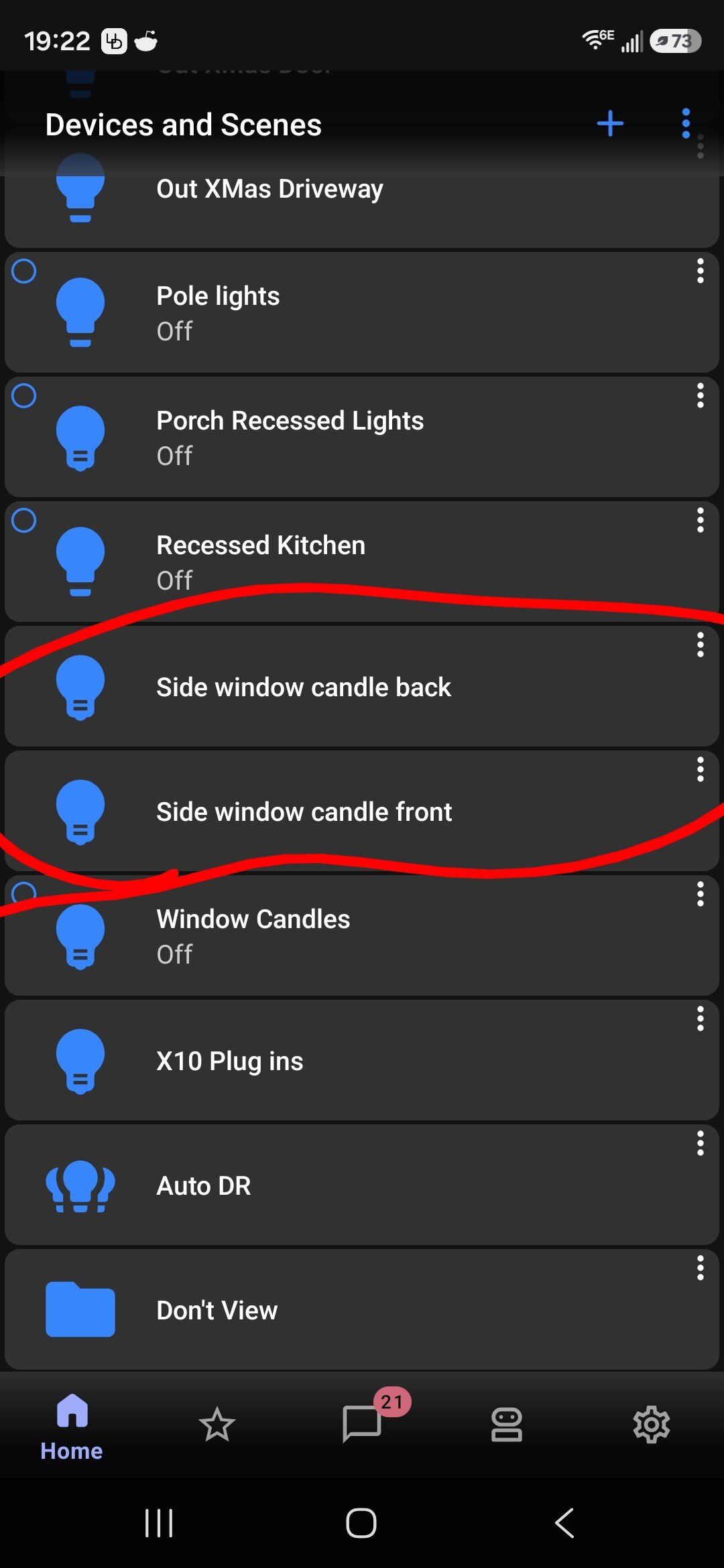

  1. Huh, I just forced a "synchronize" in the ud mobile app (which I had done before) and now it looks like it's working. Wondering if it need the cache cleared and THEN the sync to sort itself out. yep it's enabled with matter disabled so that's ok. Interesting I don't have the two smart start options you do, which likely doesn't matter either.
  2. I restarted my phone, did a power cycle on the eisy and also cleared the app cache and the excluding/including message went away but i still can't control any of the 3 z wave devices I added on the mobile device. If I hit the 3 dots and go to "configure" I get an error saying "could not get node. 500" (not sure if that's relevant.
  3. Nope, doesn't look like I have those. Only options are add, remove, synchronize (with a sub menu of new and deleted or all), options (sub menu of 4 things each with a yes/no option), advanced (sub menu of stop adding or removing, factory reset dongle, show all native links and z wave info) and then z wave version which gives nothing useful
  4. Couple hopefully small things... I got my 3 zwave devices added back and they work fine in the console and I synced mobile to console so they shoe up there but there's no way to control them. I normally could just tap the light bulb and my I stein switches turn on and off. Nothing happens here. Also On ud mobile it keeps saying z wave excluding in progress, z wave including in progress in a loop
  5. I had forgotten the default password was admin, so admin/admin worked and I got the "200" result as expected. Then I went to the configuration tab in the console, set zmatter to off, zwave to on and rebooted the eisy. Now I see the zwave tab but when I clicked it, it says dongle is not responding but then it went through a period of like reading links and such and now that that's done I have the normal zwave menu (add a device, remove a device, learn mode, etc) I did a test on one where I removed the device by putting it in linking mode (3 quick button presses on my plugin unit) and then added it back in. In the console I got 2 lines, ZW002 Binary switch which is where the on/off is and then ZW002 Basic Control 2. Not sure what that is and I don't recall having it before but it looks like I can just put it in a folder and not have to look at it if I don't want to. so.... PROGRESS!!! thanks for all the help!!
