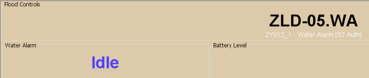

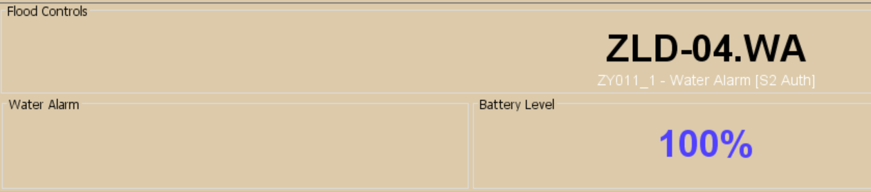

In the AC, I should see this, with Battery Level Value, as I do for another v 1.40 sensor:
?wpsc_attachment=49144&auth_code=w2I9kC3c
Instead I now see this with my v 1.50. No Reported Battery Level Displayed:
?wpsc_attachment=49145&auth_code=w2I9kC3c
So I don't know what to do to get this resolved. Not fully understanding, I would have thought the "Update with Interview" would have established any new or changed parameters for eISY to receive. Or, maybe more simply, Zooz still has a bug.
