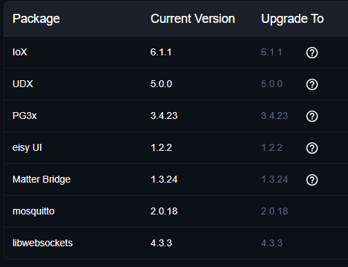

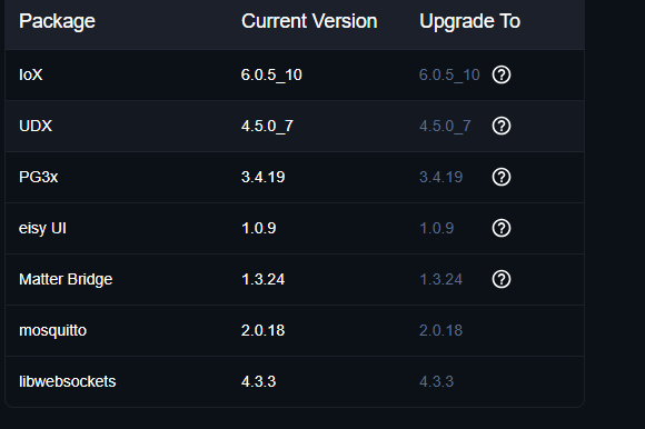

September 3Sep 3 Author Thanks Javi! Updating firmware fixed the issue. I had assumed that since the display looked like the following that it was up to date. Obviously not. Once I clicked on Upgrade Packages it found the "new" packages and upgraded.WASNOWThanks again Javi!
