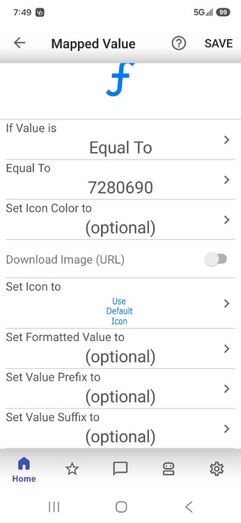

In UD Mobile I would like to set the icon, and icon color, depending whether the shade is opened or closed, but the value only references the ID number rather than the last command sent, i.e. open or closed. Is this a UD Mobile issue?

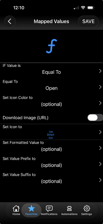

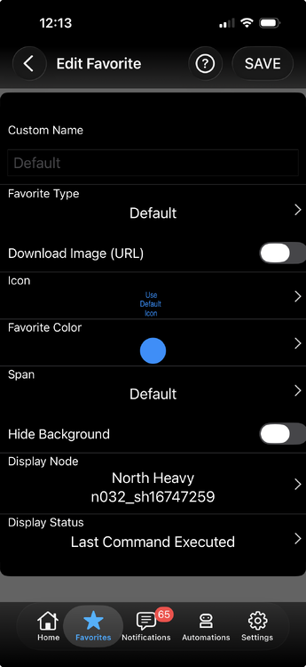

@Techman ,
It can be done:
You just need to make sure the object you are doing this with {default, command, etc} is chosen as a shade (not a scene).

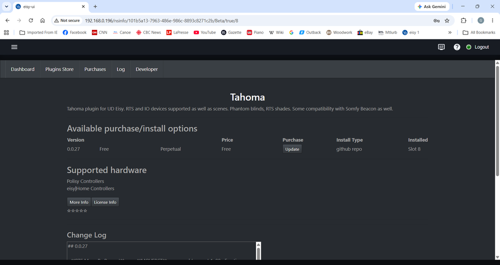

Hmm, how do I upgrade from 0.0.24? I'm trying from the dashboard, from the non-production store. It tells me it's already installed in slot 8, which is correct. But when I click on Install, nothing happens. Tried this by accessing plugins from both admin console and eisy-ui.
production is at v0.0.26
non-production(beta) is at v0.0.27
@Guy Lavoie there should be a button beside that slot 8 indicator to reinstall there. I just checked the repos & all look good.
Not sure where you're referencing that button. From the dashboard I see the plugin (in slot 8) with status = connected and store = beta. If I click on Details, I see the main screen for the plugin. If I click on Update, I see that I'm running 0.0.24. See the screen shot below. If I click on Update, nothing happens.
