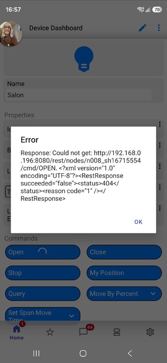

One thing that does happen when sending shade commands in UD Mobile is that I sometimes get the message below, but the command still works. Not sure what might cause that
