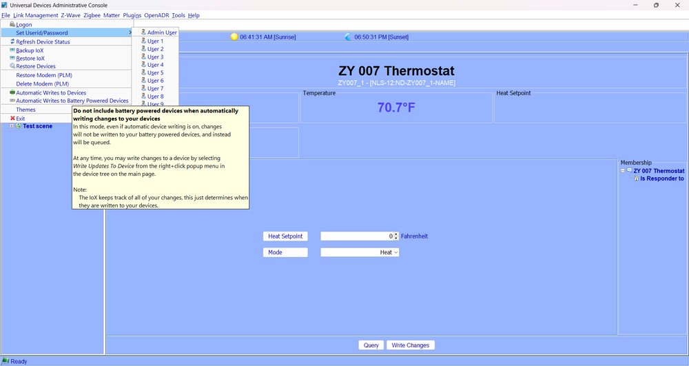

What he's asking about is if we could add a way to programmatically enable/disable automatic writes to battery powered devices. By default this is enabled, and IoX tries to write the updates periodically, which slows down other Insteon communications. In admin console, this is triggered here:
