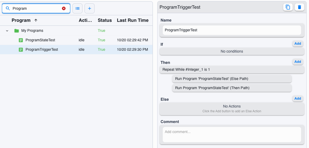

October 20Oct 20 Here is the UDI response.Hi Brent,I have replicated and have a good test case. Approval can be revoked.It may be some time before we have a fix, this was scheduled to be rebuilt so I may bump on the todo list.Will update in a few days.
October 20Oct 20 The issue is many program updates every second (see control _1 action 0 in the event viewer, the eventInfo has the program ids), most users would likely not never see this. It may be a good idea to find offending programs causing frequent evaluations, there may be an optimization, or shared optimizations, like setting a variable then checking the variable instead of frequent runs, having a shared condition in a folder with the programs as childrenEither way it is replicated with a vicious loop .The test case replicates this with a program looping over running and empty program then and else.
