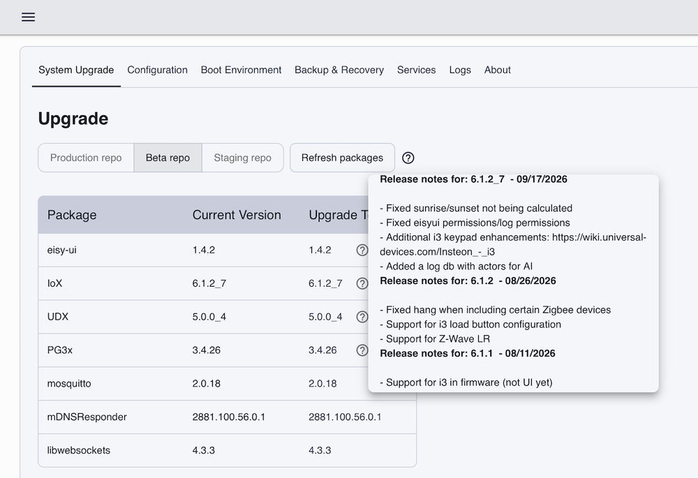

@DNewkirk I don't have a direct answer to your question about how well the I3 devices are supported under AC, so feel free to shame me for providing a suggestion, but I do have a good number of I3 switches on an eisy running beta code. From what I've seen, the I3 devices seem to be much better supported in the browser versus the old AC, so much so that I've stopped using the AC altogether.
Given the AC is going away, and you also have at least one I3 device, I might suggest considering your migration to eisy-UI sooner than later. It takes a little getting used to, but it's pretty functional now and the I3 devices seem to be well supported there, especially with recent updates specific to the I3 (as shown in the release notes - see screencap below).
Also - see https://wiki.universal-devices.com/Insteon_-_i3 for more details specific to the I3 devices.
