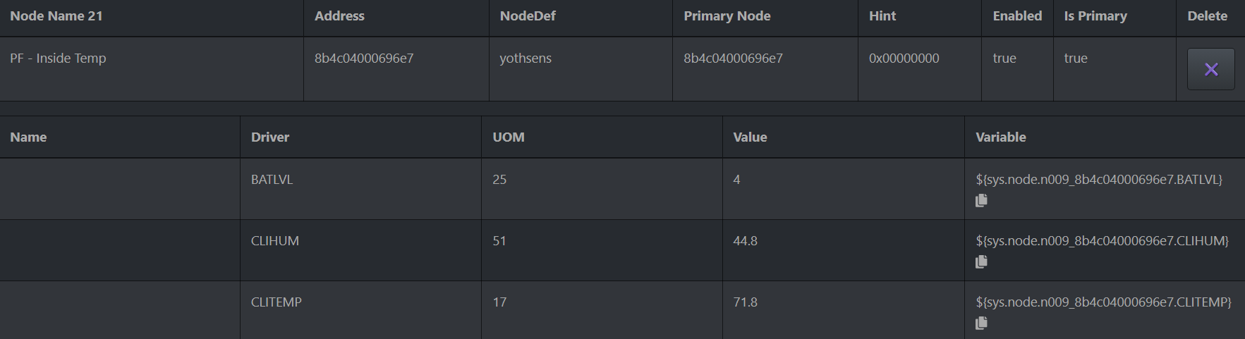

  3. Thanks Paul. I wasn't aware that a precision could be assigned to a variable and will follow your directions to fix my problem. This new knowledge opens up a bunch of possibilities including better handling of Yolink temperature values which currently are being rounded to the nearest integer. Thanks again! Mike

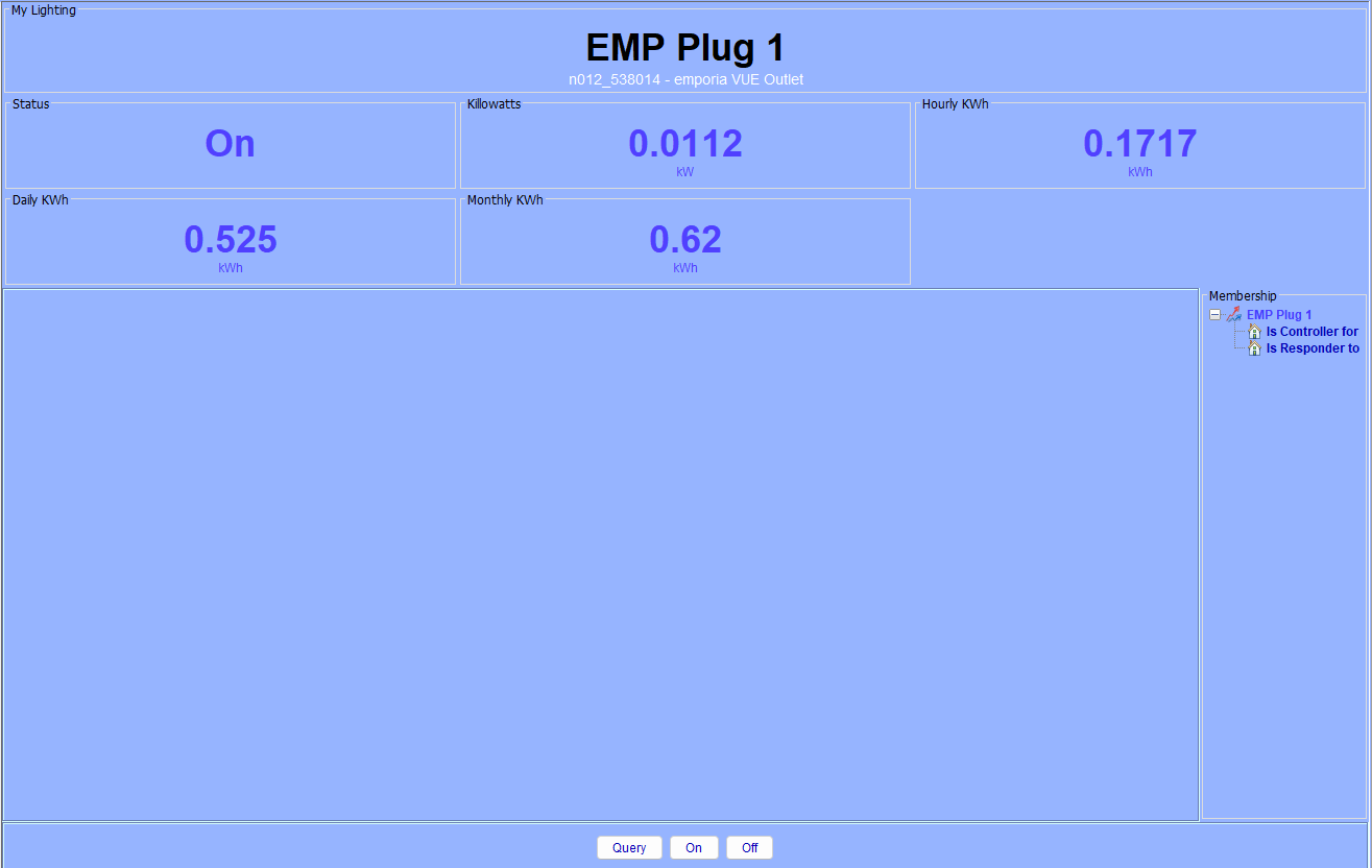

  4. I installed one of the Emporia Smart Plugs in order to monitor the on/off state of an HVAC ventilator unit. The thought was I could periodically check the power consumption through the Vue plugin and see how many watts were been drawn to determine the operating vs standby state of the unit (the ventilator is controlled by a complex algorithm in the HVAC control system which I can't access from EISY)). My plan is to monitor how the HVAC algorithm is actually controlling the unit since I suspect it is less than optimum. The problem I'm running into is the Current Power Consumption value in the node is in kilowatts but the ventilator only draws 170W while running and about 10W in standby. The node shows this as a decimal value (0.1763 KW operating or .0112KW standby) but this translates to value of 0 when I attempt to use the value in a program or to assign it to a variable (all variables are signed Integers in IoX). Is there anyway around this limitation? What would be really helpful is if there were another field in the Node that also displays the current power value in watts. Thanks Mike Operating Mode Power Standby Mode Power
  5. I ordered 1 of the Yolink smart plugs and 2 of the Emporia Vue smart plugs and will experiment with both of them. Thanks for all the replies. Mike

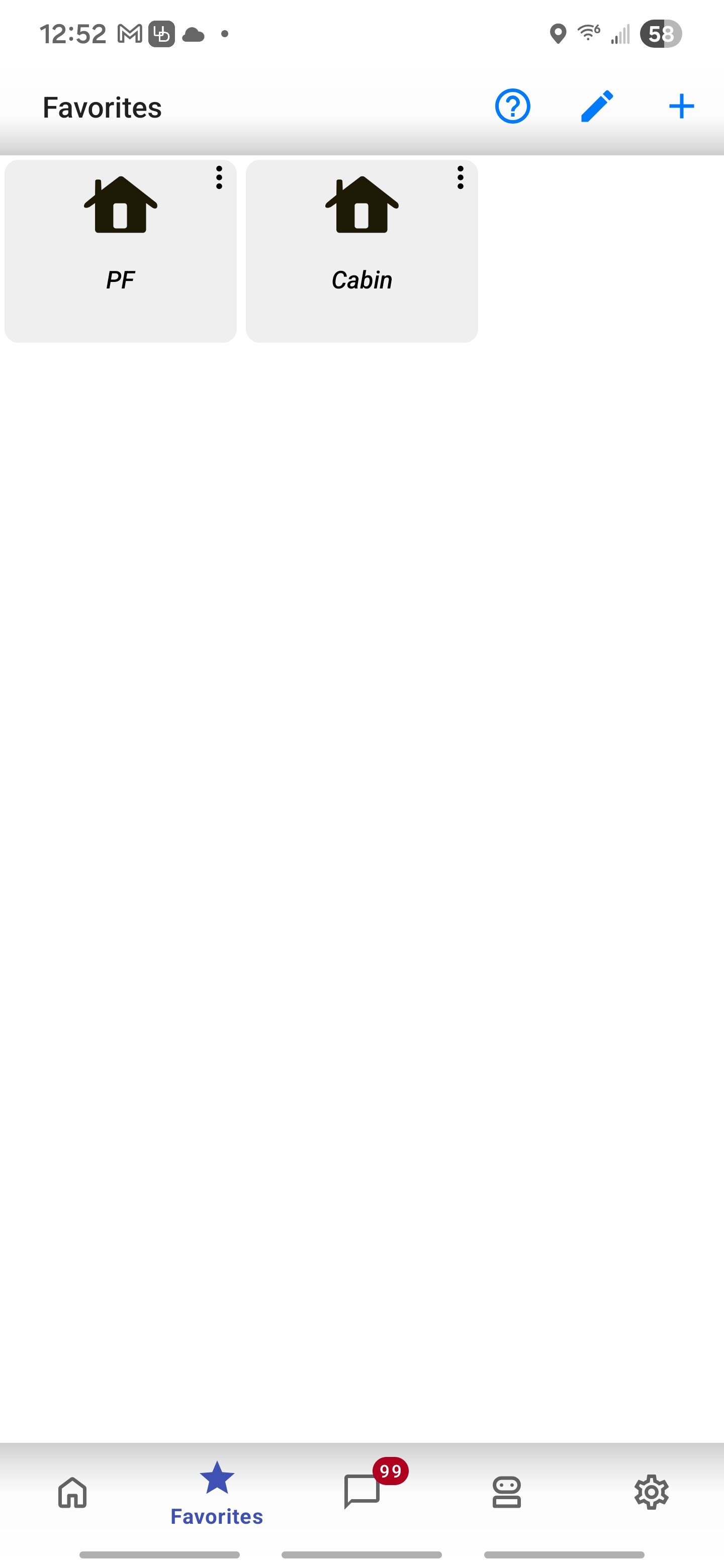

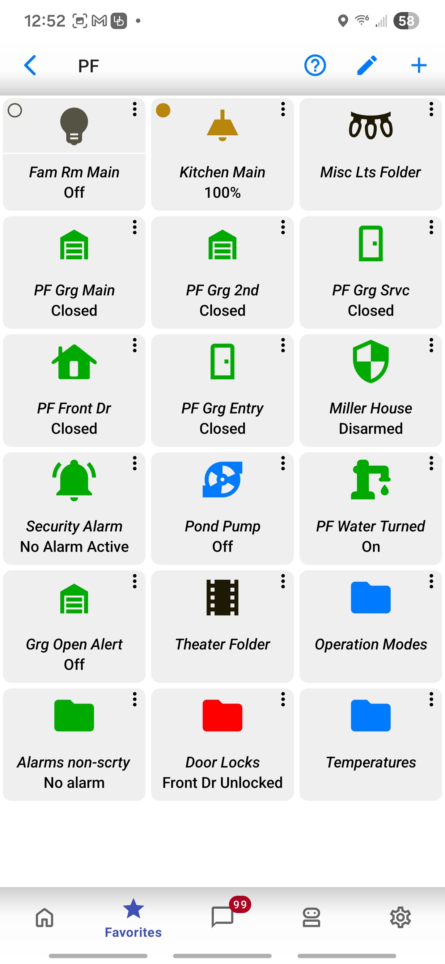

  14. First, I use UD Mobile and EISY extensively now days to manage most of my IOT devices and for the most part it is great. I have two questions/requests. 1) I use folders in the Favorite area to provide a top level view of things with the ability to drill down into subfolders when more detail is needed. For example I have two EISY systems (one in our main home and one in our cabin) so I have two folders at the top level in Favorites, one for each house. When the Folder is pressed for either system it opens a top level page that contains important details for each system along with more folders that can opened to drill down into the details. The goal is to keep the opening page for each system limited to one page so it can be viewed without scrolling. The opening page contains things like Alarm system status, buttons for kay lights, the state of various doors/windows, and folders to drill down into things like door locks, temperatures, more light controls, water sensors, etc. So far this all works well with one exception. When the back button is pressed in any sub-folder it always goes back to the Devices and Scenes area of UD Mobile instead of returning to the parent folder. Is this be design or am I doing something wrong? If it is by design is there a workaround could be implemented? It would be way more convenient and intuitive if the back button returned to the parent folder. 2) Expanding on the 1st topic I also use the Advanced Status Configuration settings to control the color/icons/Info displayed on many of the buttons and folders. For the most part this meets all of the needs for conveying information concisely for the buttons and folders. The one exception I have run into is that the Advanced Status Configuration is only able to use the Node defined in the Favorite, that it is associated with, for its comparison function. I have some situations where it would be real handy to be able to specify the node that the Advanced Configuration Status uses for the comparison. For example, I have temperature buttons for various temperature sensors where each of the buttons shows the actual temperature in its status field. I then use the Advanced Status Configuration for each button to changed the color of the Icon to show weather the temperature is out of range for that sensor. For some sensors this is 3 states, High, Low, and Normal. This can be calculated easily in a program and assigned to a variable but if this variable is used for the Favorite then the actual temperature can't be displayed. It would be real handy if the node used for the Favorite and for its associated Advanced settings could be selected independently. If there other ways to accomplish this I'm open to advice. Here are some screen shots of several page configurations I have set up - Top Level - The 2 houses 2nd Level - PF (Home) 3rd Level - Temperatures Folder

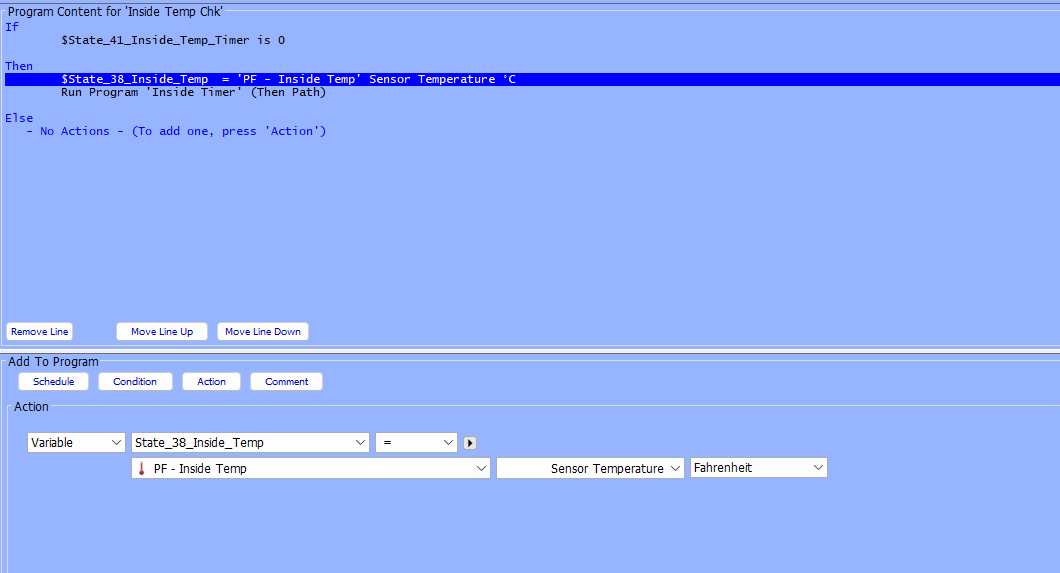

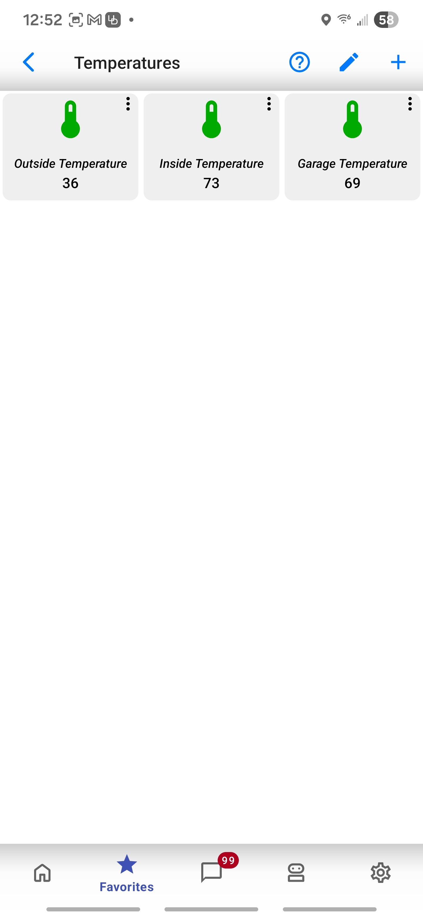

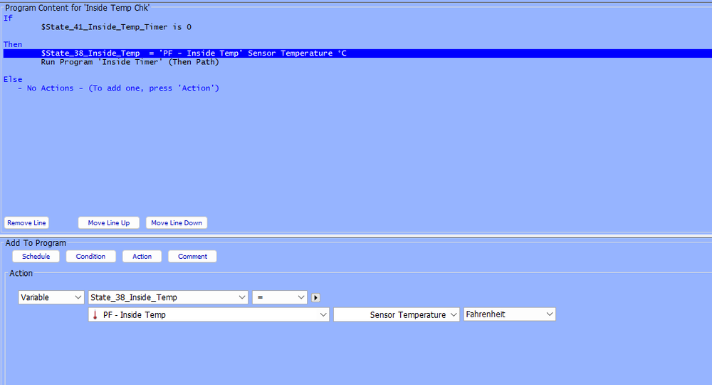

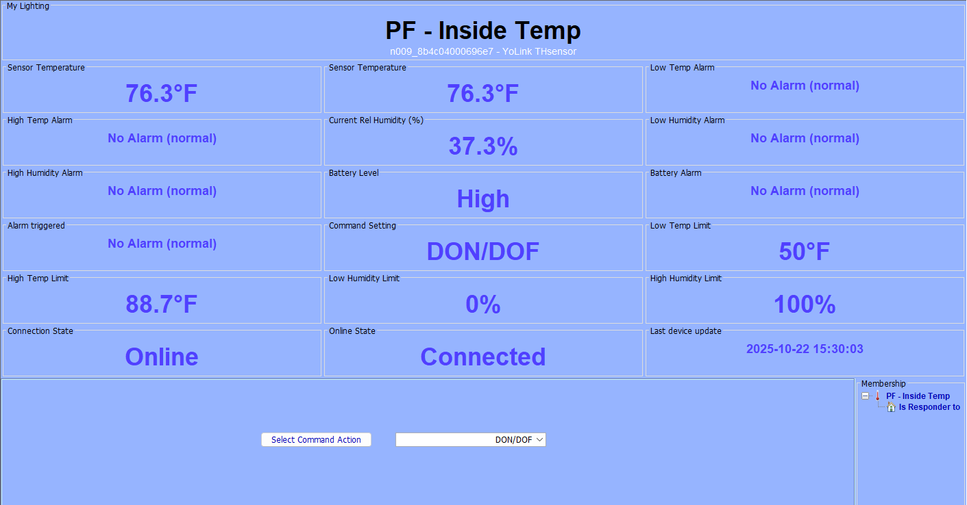

  18. Thanks for the feedback. It does appear to be related to the console since I can select Fahrenheit in the drop down box but it doesn't get applied when the Action is applied. As I mentioned in my first post I have an Ambient Weather system and have the plugin for this system installed. When I create a program using this plugin it allows me to select Fahrenheit or Celsius and the correct selection gets applied when the Action is added to the Then or Else clause. I think this means that it is possible for this to work but perhaps it means, as you said, all of the temperature values would need to be duplicated in the node. It would take looking into the Ambient Weather plugin to see how it is done there. I'm surprised no one else has run into this? My next step is to try and implement the math to do the conversion in the program. Thanks again!

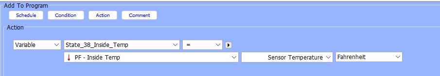

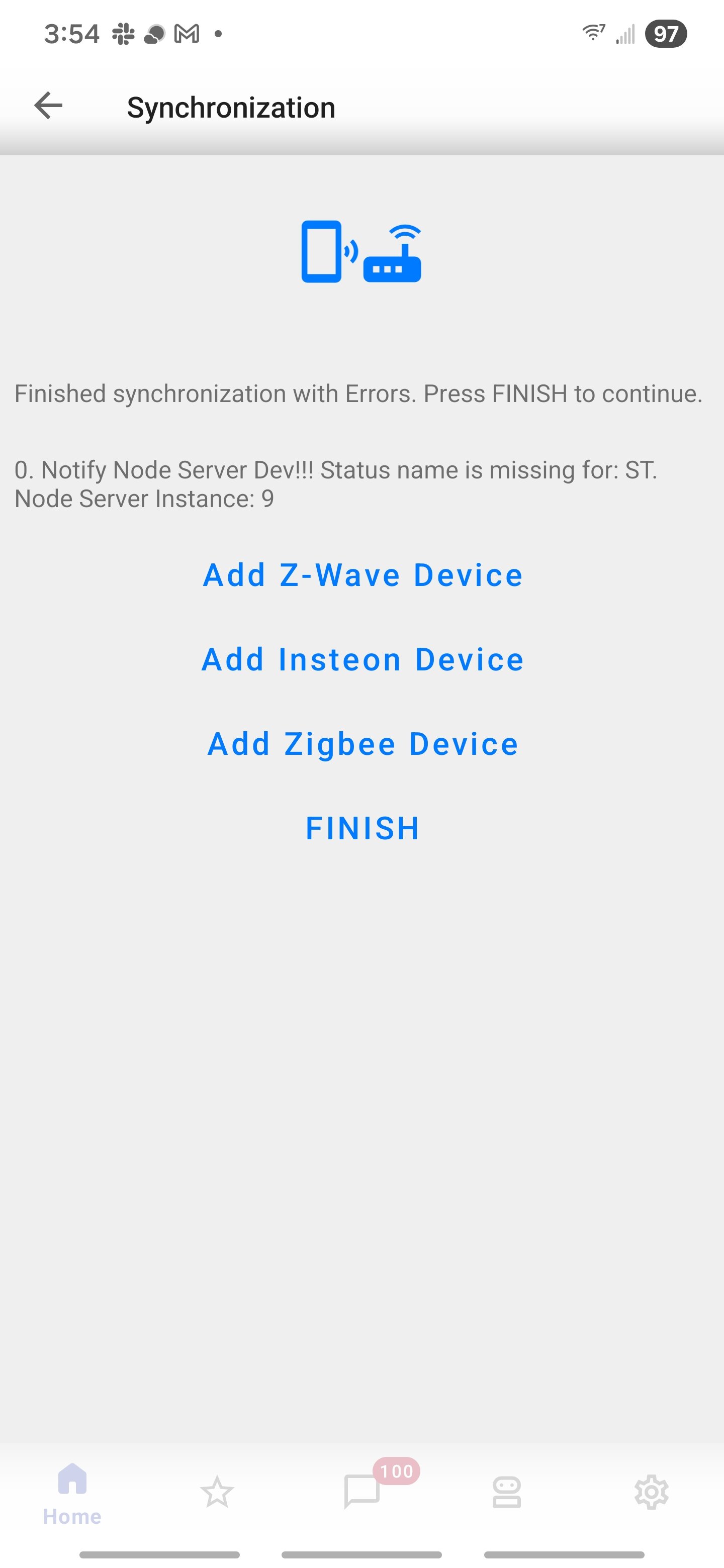

  19. Update - After investigating some more I'm even more confused. When I look at the Yolink temperature sensor node in the administrative console it shows the correct value in Fahrenheit, which is what is selected in the Yolink plugin in PG3. What I have noticed is that when I select Fahrenheit in the Program settings dialog box it does not reflect this setting when added to the Then clause in the program. Ex - The Yolink Node is at version 1.6.2 and is installed in slot 9 in PG3. I have noticed recently that when I synchronize UD Mobile with EISY it is complaining about a Status Name being missing for Node server 9. I'm not sure what this is about.
  20. I think there is possibly a bug in selecting the Fahrenheit temperature reading for a Yolink temperature sensor in a program. I'm working on displaying various Yolink temperature sensors in UD mobile. I have a program that reads a temperature sensor and assigns the temperature to a variable. When I check the variable it always shows the Celsius temperature regardless of selecting Fahrenheit or Celsius in the drop down box. When I check the node in PG3 it shows the correct temperature in Fahrenheit. I also have an Ambient Weather station and if I select Fahrenheit for it's temperature sensor I gets the correct number. In the PG3 Yolink configuration I have TEMP_UNIT set to F Is this correct? How does this interact with the Program dropdown selection of Fahrenheit vs Celsius?
