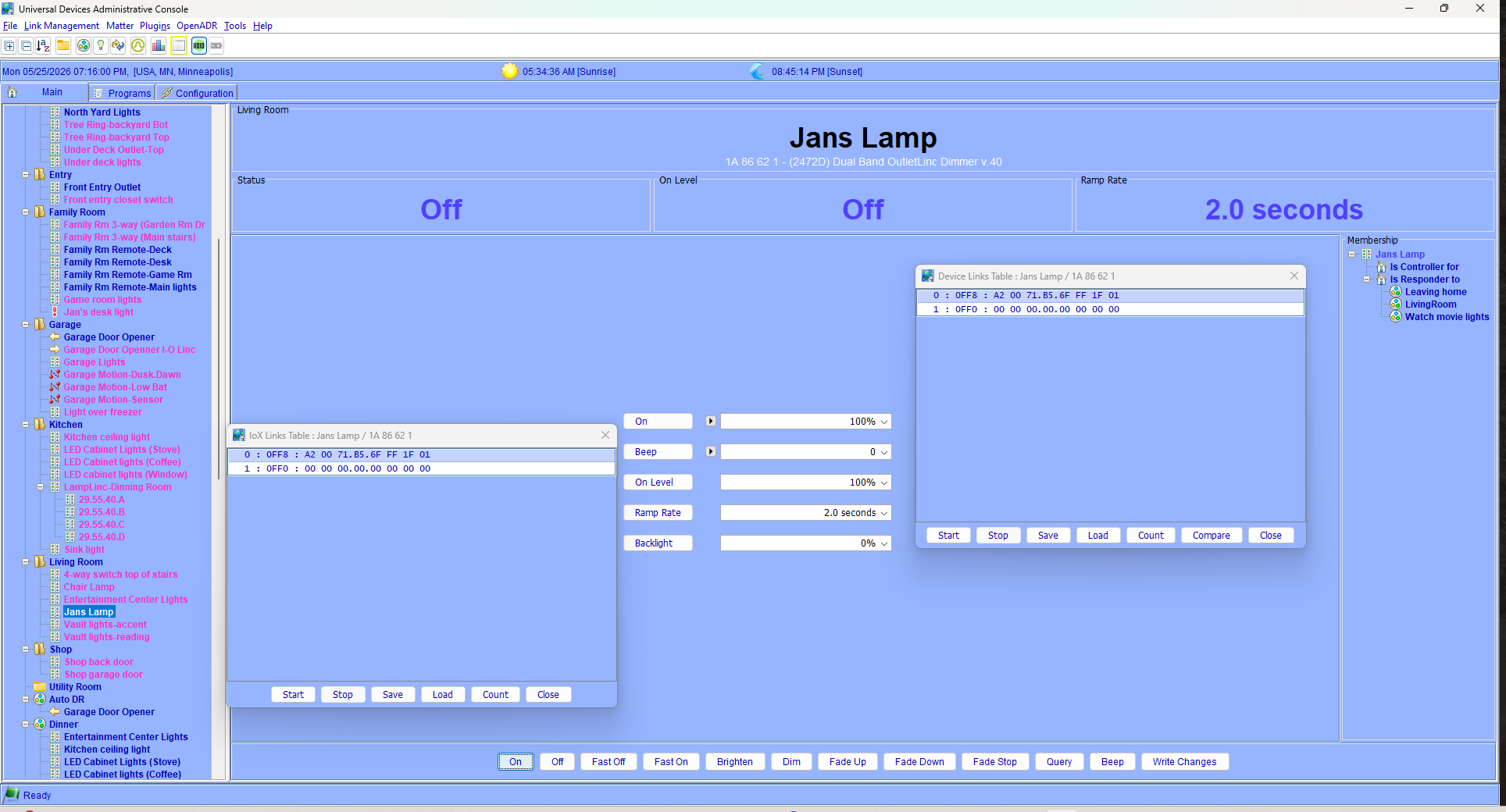

  4. I think we've achieved the point of delete and attempt to add back. I did get a couple devices to respond to EISY commands but there are several remaining such as Jan's lamp (lamp on end table where she reads) that just do not respond. Shows status but no response. See attached screen shot.

  6. @IndyMike Had to look up how to do a level 3 Event log. Think I got it. One of the devices that I can't get to communicate is the Jans Lamp I tried including before. Did another restore for that module (node) and ran the Event Viewer log. What the log has to say is above my normal grade. ISY-Events-Log.v6.0.4__Mon 2026.05.25 05.53.14 PM.txt
