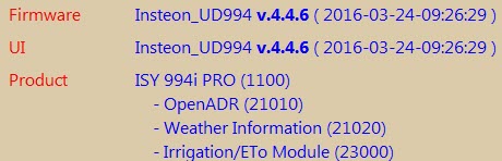

Hello Orest,
Can you please confirm in the Admin Console that both the UI & Firmware are the same: Help -> About
On my two newer units of four that I have pressing the button for about two seconds sends an off and pressing the button very quickly sends an on.
Hello Orest,
Yes, they are.
* Orest

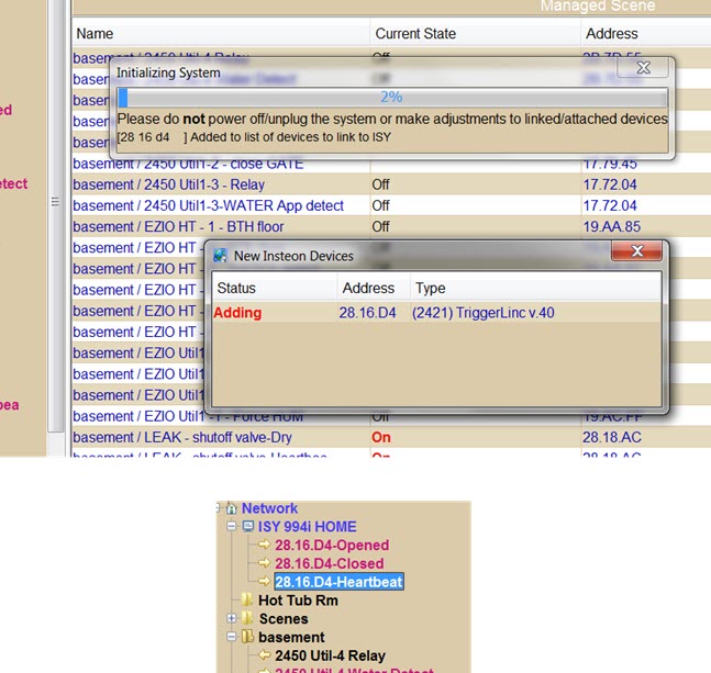

OK, did the factory reset, battery is good.
I do have to hold the button down about 3.5s or so, else there is no blink, and no device seen.
Used Auto discover, same results, two pics below.
* Orest

The unit is 0114 revision 2.1 firmware v.40
* Orest

OK, upgraded to 4.5.1 for firmware & UI.
Deleted the unit.
Tried autodiscover, ended up with Triggerlinc like before.
Deleted the unit.
Tried again specifying 2852-222, ended up with Triggerlinc.
So still, no joy,
* Orest
