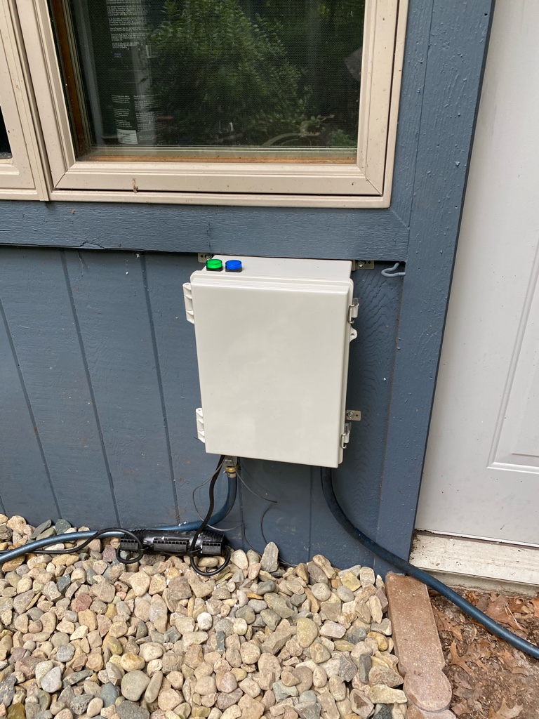

Just recently, however, I tackled a new project that I’m pretty happy with. It’s a pond filling system. We have, what you’d call a water feature, behind our house. It’s composed of an upper and lower basin, connected by a little creek that allows the upper basin to flow down into the lower. The upper basin isn’t that large but the lower basin is probably about 1000 gallons of water. There are a couple of water falls and a pump box in the system to keep the water moving. Because of splash from the waterfalls and evaporation in general, the system loses water over time.
The Insteon system I set up has two stainless float switches that control a high and low water point. Each of those switches are wired to an Insteon I/O Linc. There is also an Insteon outdoor outlet in the system that when on, opens a solenoid valve to allow a garden hose to start filling the pond. All the Insteon stuff is housed in a weather tight project box. The I/O Lincs turn the outdoor outlet on and off. Because the float switches each have an open and closed state, I have to make sure the solenoid valve only opens when the lower float switch is closed and shuts off when the upper float switch is open. (Both float switch states are closed with the float in the lower position and open in the upper position.)
Initially, with this configuration, I tried setting up a scene where the IO Lincs both controlled the outlet. That didn’t work because when either switch state was reached it would affect the outlet switch. In other words, when the water got low enough to let the lower float switch close and turn on the outlet, it also turned off the outlet when the lower float rose with the water level and opened the switch, well before the water got to the desired upper float level.
Easy fix. Just write a couple of short programs instead of using a scene. If lower float IO linc is On (float switch closed) them turn on the outlet/water. Second program, IF upper float IO Linc is off (float switch open), then turn outlet/water off.

So finally, my question: I noticed when using a scene and physically manipulating the float switches to test it, the system responded practically immediately. When using the programs, there is a noticeable delay of about 1-2 seconds before the system reacted to the float switch changes.
Is it possible, WITH A SCENE, to have two IO Lincs control one outlet but only with a single state change from the float switches? By this, I mean can the lower float IO Linc have the water turn on when the lower float switch is in the closed position but IGNORE the lower float switch when the water rises a little and shifts the float to the upper, open position and continue to fill the pond until the upper float switch is pushed to the upper/open position, turning the valve outlet/water flow, off?
With the reverse being true as well, can the upper float switch IO Linc ignore when the upper float drops to it’s lower closed position and not turn the water on until the water drops enough to allow the lower float switch to handle the turn on the water state?
This is obviously child’s play for a program to accomplish, but I didn’t see anywhere in the ISY system that allowed for that kind of detailed control in a scene. (Probably why programs are needed. ;-) The only reason I ask is because I noticed how much faster things happened with scenes vs programs. I don’t need my pond watering system to react that fast but I can think of other situations where near instantaneous reactions would be desirable.

Here’s some pics of the setup if anybody is curious:
Sent from my iPhone using Tapatalk
IMG_1532.thumb.jpg.12d3838eebef250f31419a9db31f05d8.jpgIMG_1536.thumb.jpg.337b0a7500d47ec3831267ae4f56baba.jpgIMG_1535.thumb.jpg.43f929962563606614abdb0dc26a3e37.jpgIMG_1527.thumb.jpg.8f1e4c5b8c362cbfab12a9f41dd5657d.jpgIMG_1444.thumb.jpg.fbf763b8584f4e892c9bb298fa9d086d.jpgIMG_1445.thumb.jpg.8daa8cde58828f46d0c74acd96cd0329.jpgIMG_1447.thumb.jpg.7a3507d7db4b6de37b5b5f805cd97f94.jpgIMG_1448.thumb.jpg.33c300ce646567537e3d712cd951beb9.jpgIMG_1450.thumb.jpg.af0c03bcbd37763109ede8255986c09e.jpg

Hi Larryllix,
I tried the solution you suggested, one scene with the IOLinc connected to the lower float switch as a controller and the pond water valve ON as a responder. A second scene with the IOLinc connected to the upper float as a controller and the pond water valve OFF as a responder.
It’s not working.
Each individual float will turn the pond water valve on if a float reaches the down position and off when it reaches the up position.
I can’t seem to find a way for the IOLincs to ignore one position of their respective floats.
Could it be in my physical setup? Each float switch has two wires. It’s a simple completion of a circuit; Open or closed. I have one wire connected to the IOLinc ground terminal (GND) and the other to the sense (S) terminal. One float switch per IOLinc, both set up as described.
I can’t seem to click on anything in the scene setup that allows me to customize the conditions to be more specific than controller, responder, on, & off.
I’m looking for something like ‘ON only’ or ‘Off only’ but it doesn’t seem to be an option in the ISY.

The other thing that comes to mind is to put in a latching relay with each float activating Latch and Reset. Then run one I/OLink off the contact. You can get many voltage rating on P&B? KUPxxxxx relays for decent prices. I was a protection and control tech for 35 years and wired control panels for 5 years before that. I still remember some relay solutions from back then. :)
Edited by larryllix
I was just about to suggest a latch.  As I see them, the requirement looks like:
Float Position Lower Limit
Sensor
Upper Limit
Sensor
Refill Valve
Both Up OFF OFF Turn Off
Lower Up, Upper Down OFF ON Ignore
Lower Down, Upper Up ON OFF Not Possible
Both Down ON ON Turn On
So if you use the Lower Limit sensor as the SET signal for the latch and invert the Upper Limit sensor signal and use it as the RESET for the latch, the output of the latch could then be used to control the IOLinc.
