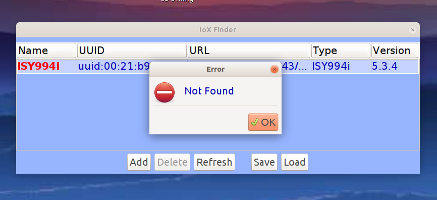

1) It displays a "Not Found" message twice when launching (two pop-ups). (See screen capture)
But after clearing the two pop-up dialogs, the admin console launches.

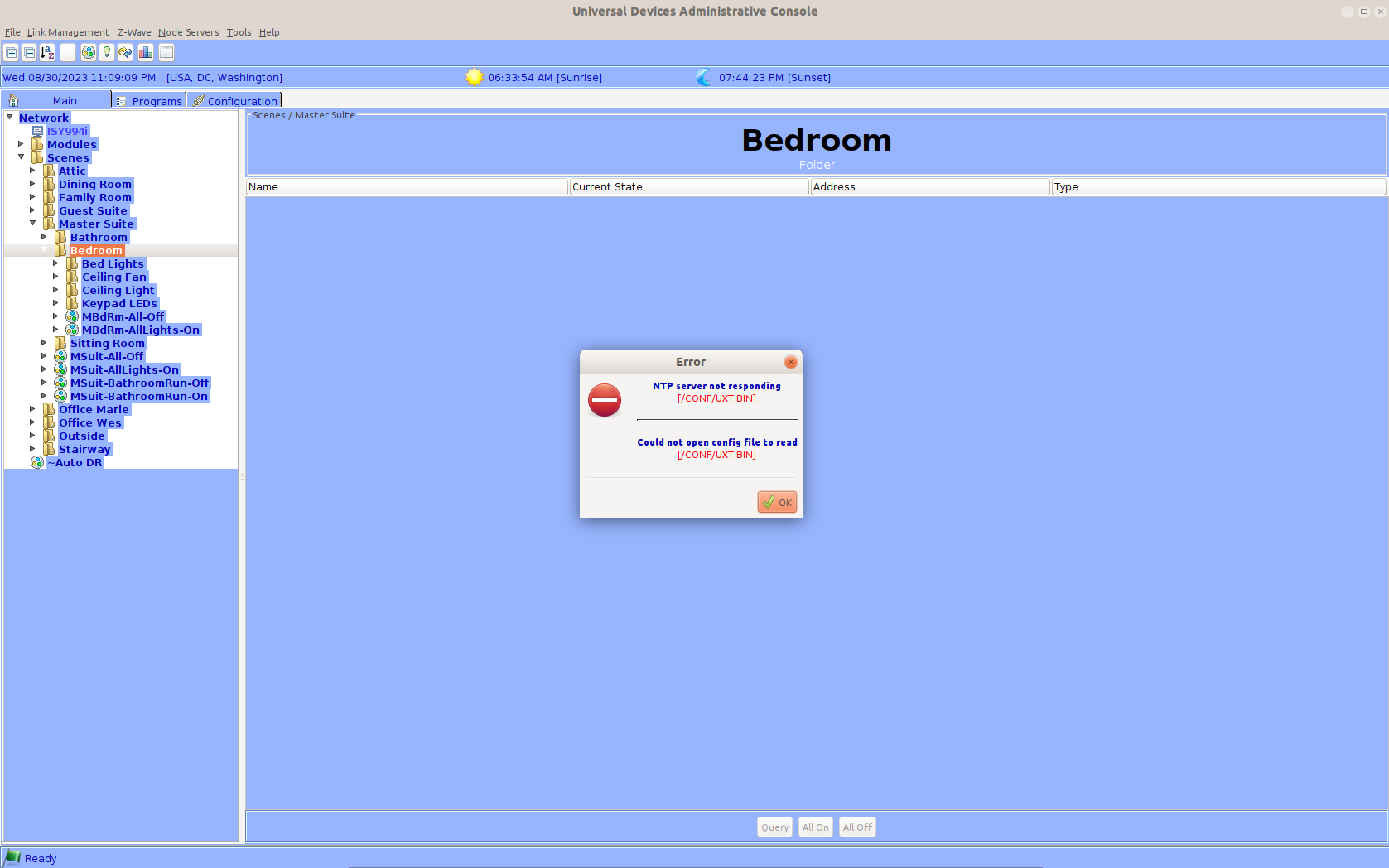

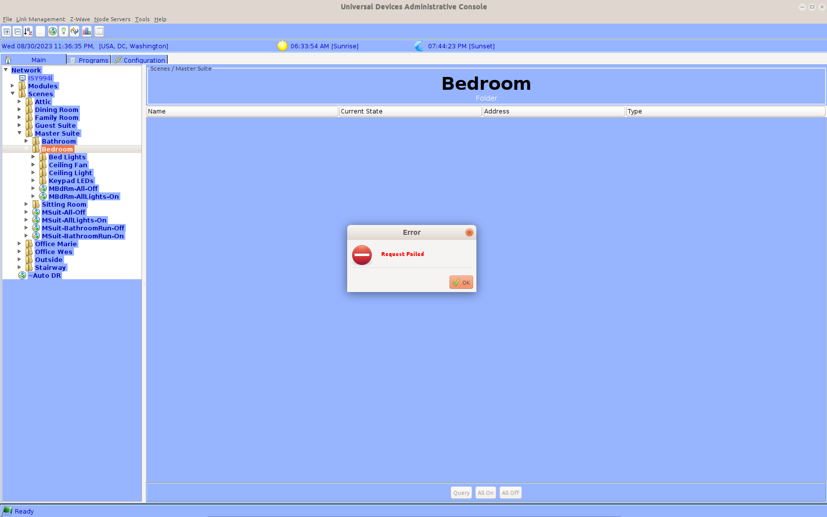

2) It won't let me create new folders. (See screen capture)
Sometimes a pop-up appears and other times creating a new folder produces no response at all.
3) It won't let me create new scenes. (See screen capture)
Sometimes a pop-up appears and other times creating a new scene produces no response at all.

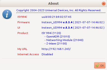

Do you have the PRO module? That expands the size of the modules,scenes and program data memory size? It almost looks like you may have hit the limit. There is a way in the Administrative Console. To condense the database by removing data marked as no longer used and just filling an entry.

to add to  @Brian H comments, the fastest way to know if you have Pro vs non-pro is to look at the admin console ribbon... if you see these two buttons at the end of the ribbon image.png.a50aed666ffe3107268aab4378e0de77.png you have pro, if they are missing you have non-pro.  The second fastest way to check is Help>About.... the section about product will contain the word "pro" probably on the first line of that section.
If you don't have pro, it can't be added anymore because the 994 is deprecated.
I don't believe I have the PRO version of the ISY994i. (See screen capture)

I just noticed that the launcher says "IoX Finder"? (See screen capture)
I think it used to say "ISY Launcher".

OK. So "IoX Finder" is a later version of the application? But what the heck is it looking for that it can't find (twice no less)?
The error message is just about useless in diagnosing the problem. (See screen capture) If I had ever released software with such a useless error message I would have lost my job.
-Wes
