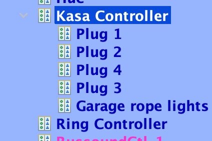

@toptierweb  Just to double check the obvious, some of the node servers load in as a "group".  The controller is the Top level. Is there an arrow to click on the left side of the controller node to expand the "group"?
If so if you click it, it will expand and show the other nodes. If this is not what you like for layout, you can right click and select Ungroup and all the sub nodes will move out to the main level. Screenshot2025-05-10at9_04_00AM.jpg.0d635c94076f4d5721d0b98a5ceab609.jpg

They are HS200 which is an hs220 but just a switch not a dimmer.  They seem to be working now or at least allowing on /off and showing me status.
All of a sudden it started showing up.  Now if I can get my home assistant to expose them to homebridge that would be great but I cant seem to find which domain they are under.
