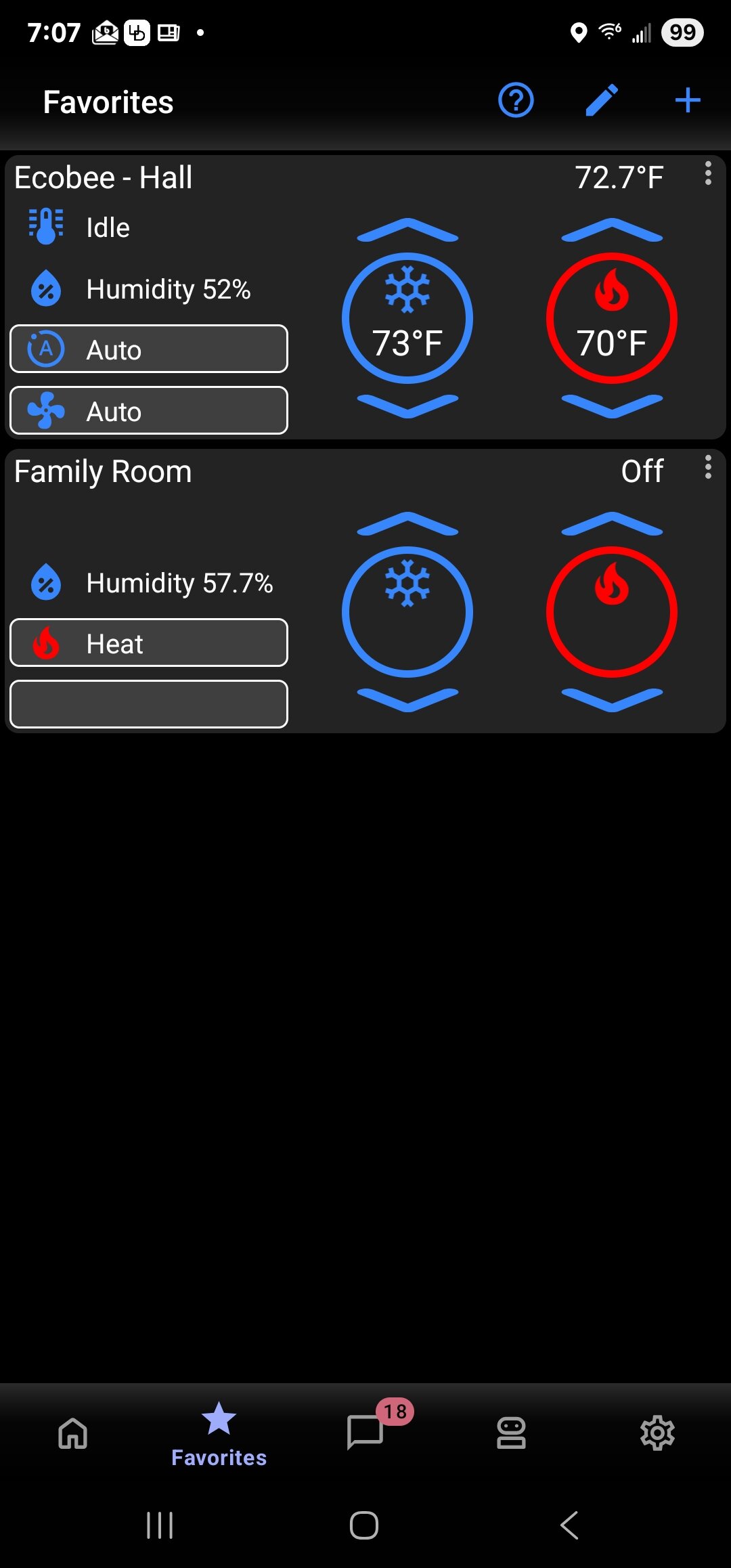

June 15, 2025Jun 15 Author I have not used eisy-ui so I can't speak to that. I have Sensibo devices for controlling my mini split heat pumps. And I have ecobee thermostats for controlling my hydronic oil heat. The display in both IoX administrative console and on the android version of UD Mobile look the same with the sensibo coded either way (uom 25 or 67) and the ecobee which does use uom 67. The only difference I see using oem 67 verses oem 25 is the actual text displayed for the mode. In version 2.0.8 we have it displaying the correct modes using the string definitions in the API table for Thermostat mode. They don't exactly match the text that the sensibo mobile app and web app display for the modes. For instance uom 67 displays "Fan Only" verses "Fan" and "Dry Air" verses "Dry". But these still make sense. Using oem 25 and the MODES array, the text matches the modes used by sensibo in their apps. I can test a version that corrects the nodedef and editor to use 67. It would not take me long to redo the programs I have if that is needed. Since I'm not setup as a developer I have to edit the files on my EISY to try out changes. If you think that is the best way to go, I can either try to make the changes myself or I can test out a version you create.

June 15, 2025Jun 15 I wouldn't expect the AC to look any different, but I'm surprised that the UD mobile doesn't. Here's what i see for a normal thermostat on the IOS version. I wouldn't expect the Sensibo node to display like that unless it used the same type of nodedef/editor/nls profile files. I understand it's a bit of challenge to make changes without being a developer, but you seem to understand how to work around that with the diff's and such that you've provided already. I can make the changes, but since I don't have any Sensibo devices, I can't test that the changes do what I think they should. But if that's easier for you, I can do that and release an updated version. I looked at the fan modes and it's missing both "low" and "strong" so it doesn't seem like a good fit. The Insteon thermostat fan modes are just on and auto so that's even worse. I went ahead and made the changes to the editor for mode so you can re-install version 2.0.9 and see if that works
