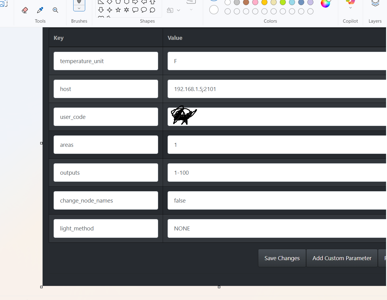

I just got an eisy and installed the Elk plugin.  The documentation on using the Elk plugin isn't very good, and I can't figure out how to point the plugin to the Elk system.  Also, there is no documentation on how to use the Elk zones and outputs in eisy programs.
If someone can give me a clue on these things, I would appreciate it.  Also, if someone could point me to the Elk plugin documentation, that would be great.

I assume you have the elk xep unit and it is connected to your LAN.  It has instructions on the config page.  Here is my setup.  Once you do that, it all shows up on the ISY admin console and you just plug the nodes into programs as you see fit.
I have the M1G with the M1XEP interface.  The Elk module worked perfectly on my ISY994.
I did that, but the configuration in the admin console under plugins (plugin 1-the Elk) doesn't indicate these values, and doesn't seem to change the values once I come out and come back in to the plugin.
Where, exactly, does the Elk plugin parameters show up in the admin console?

Did you read my reply in your other post?
All configuration is done in Polyglot, PH3x, not admin console.
After changes in PH3x you need to close and then reopen admin console.
