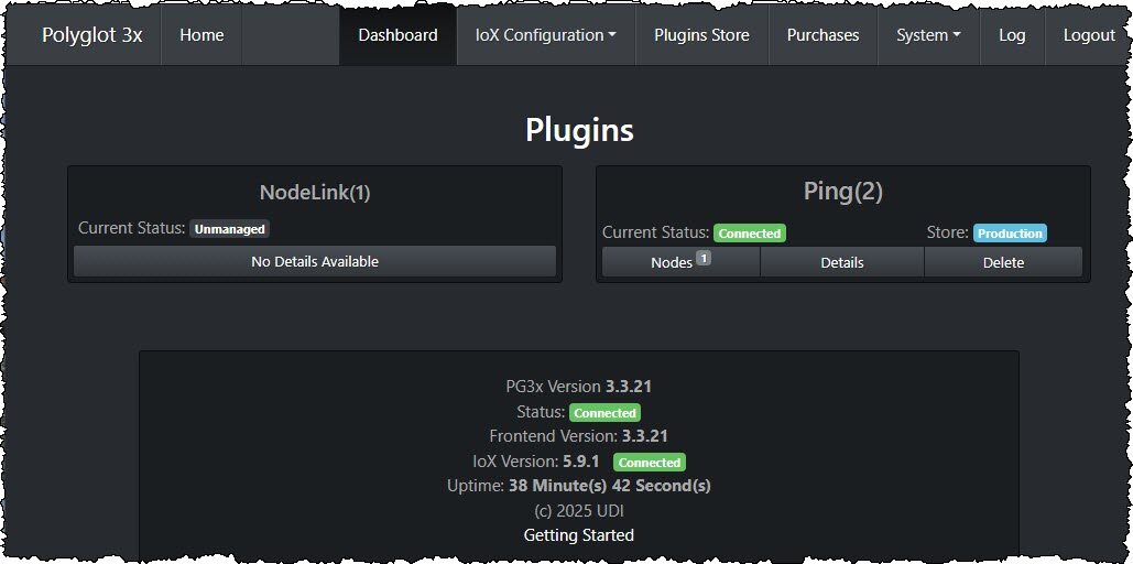

Yesterday I migrated my ISY-994i over to an EISY.  I had previously used a PG1 level node server called NodeLink to communicate with my OWFS (OWLink) and my GenMon.  I have the NodeLink application running on a RPi.  I was under the impression that NodeLink would NOT work in EISY and PG3, which is why I was trying to use the MQTT node server.
However to my surprise, I found that if I added the port (:8080) to the end of the ISY IP address, the old NodeLink node server started communicating with PG3 and EISY as an unmanaged plugin.
Below is a screen shot of an Attic humidity and temperature sensor in EISY.  The GenMon Generator and ISY Data nodes are working as well.
HOW I MIGRATED TO EISY:
1. While still in ISY-994i, I created a backup.
2. I restored the 994i backup to the EISY.
3. Got everything working between the EISY and PG3.
4. I logged into the NodeLink interface running on the RPi and added the port (:8080) to the end of the IP address Nodelink is using to communicate with the ISY.  NodeLink started posting data to EISY!
I hope this helps anyone else wanting to upgrade to EISY but hesitating because of NodeLink.
