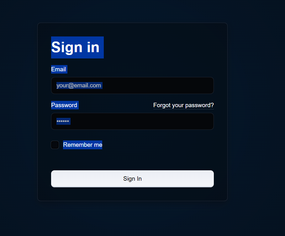

That worked.
Now I just need to figure out how this works.  First impression, I clicked to create a tile and got a list of my nodes.  Every folder was fully expanded by default.  The standard admin console seems to do this too.  This kind of defeats the whole idea of putting things in folders.  You should have them all default to closed and let the user drill down to what they want.  Having all the folders expanded is almost the same as not having folders.
