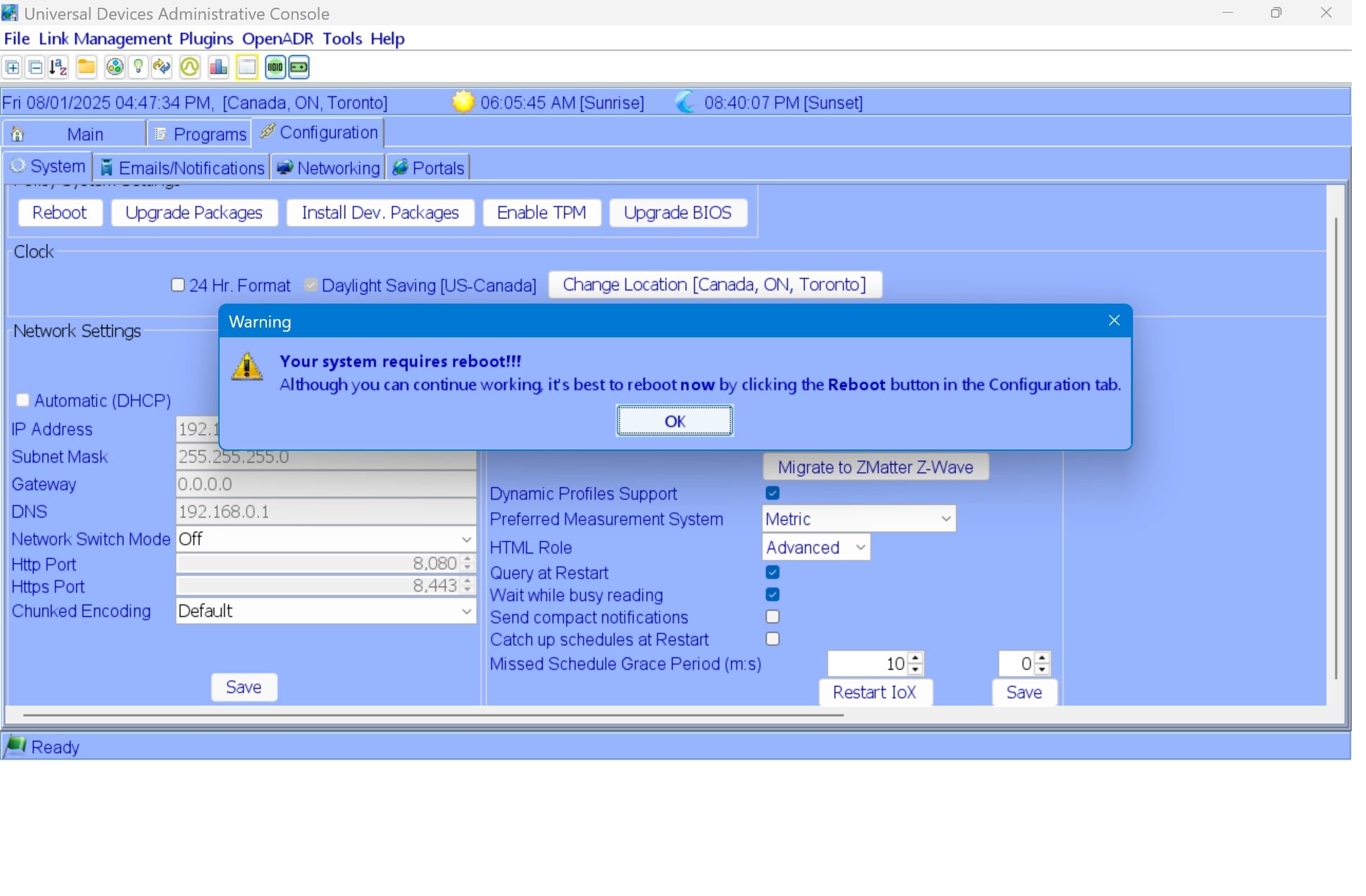

I cannot get my polisy to upgrade to v5.9.3 at all. I have tried using ISY Portal and IoX many times but nothing ever happens after the time it takes to reboot etc.
Messages are confused saying not to reboot and then flagging me I need to reboot. Java has been upgraded. Old files deleted and new IoX loaded several times but still showing v5.9.1.

Just a thought, being that eisy-ui is only supported by the eisy it's possible that 5.9.3 is not yet available for the polisy
Yeah possible but I thought it wouldn't be offered by the IoX on polisy. However to handle the problem it may look exactly as what happened. Just ignore it. Some flag message would have been nice though.
My guess is you are right on this. The updating module only discovers it, (the mismatch of versions)  after loading and doing it's preliminary testing, and then in a dumb and drastic recovery method, tells you to reboot.
