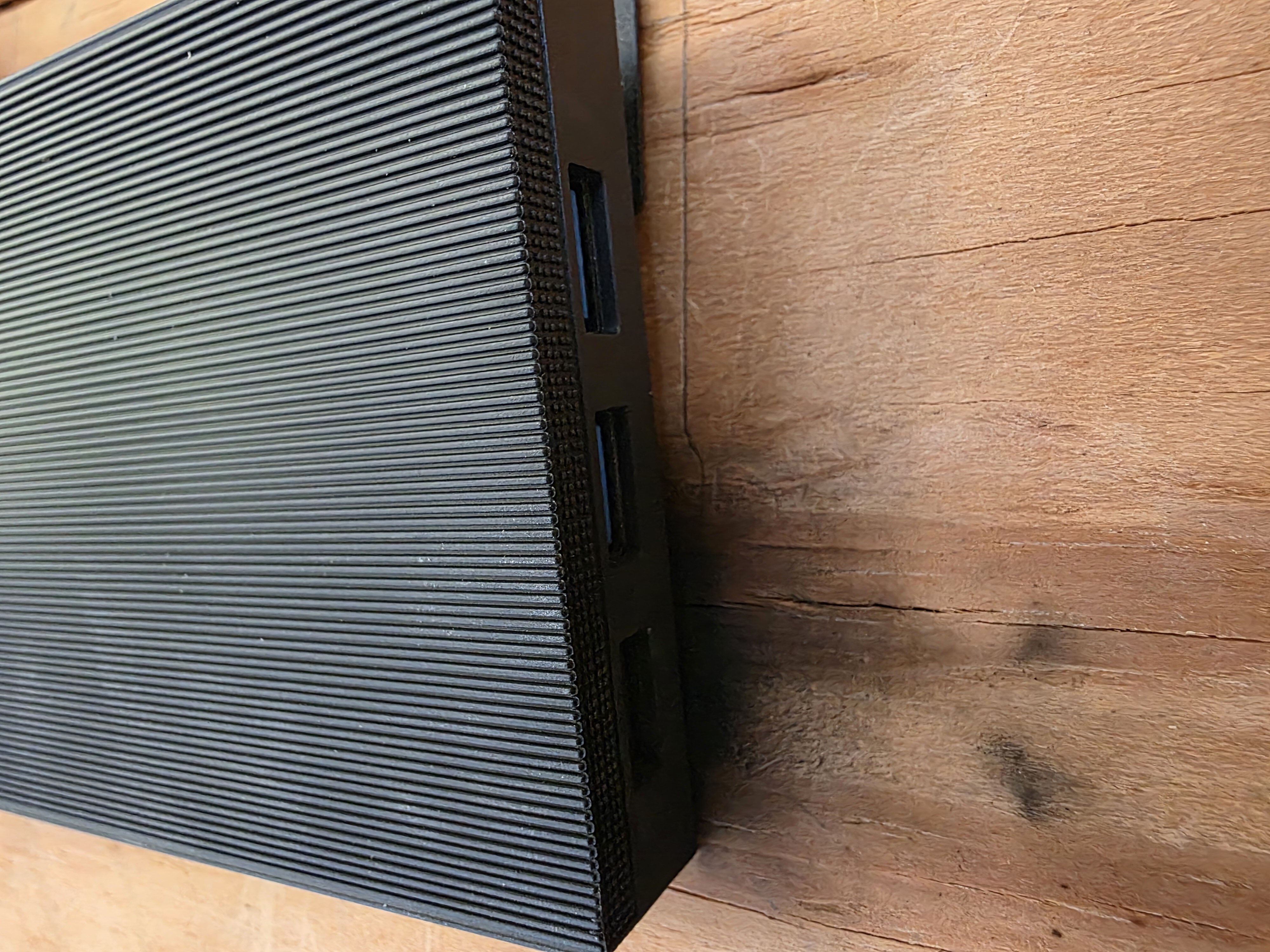

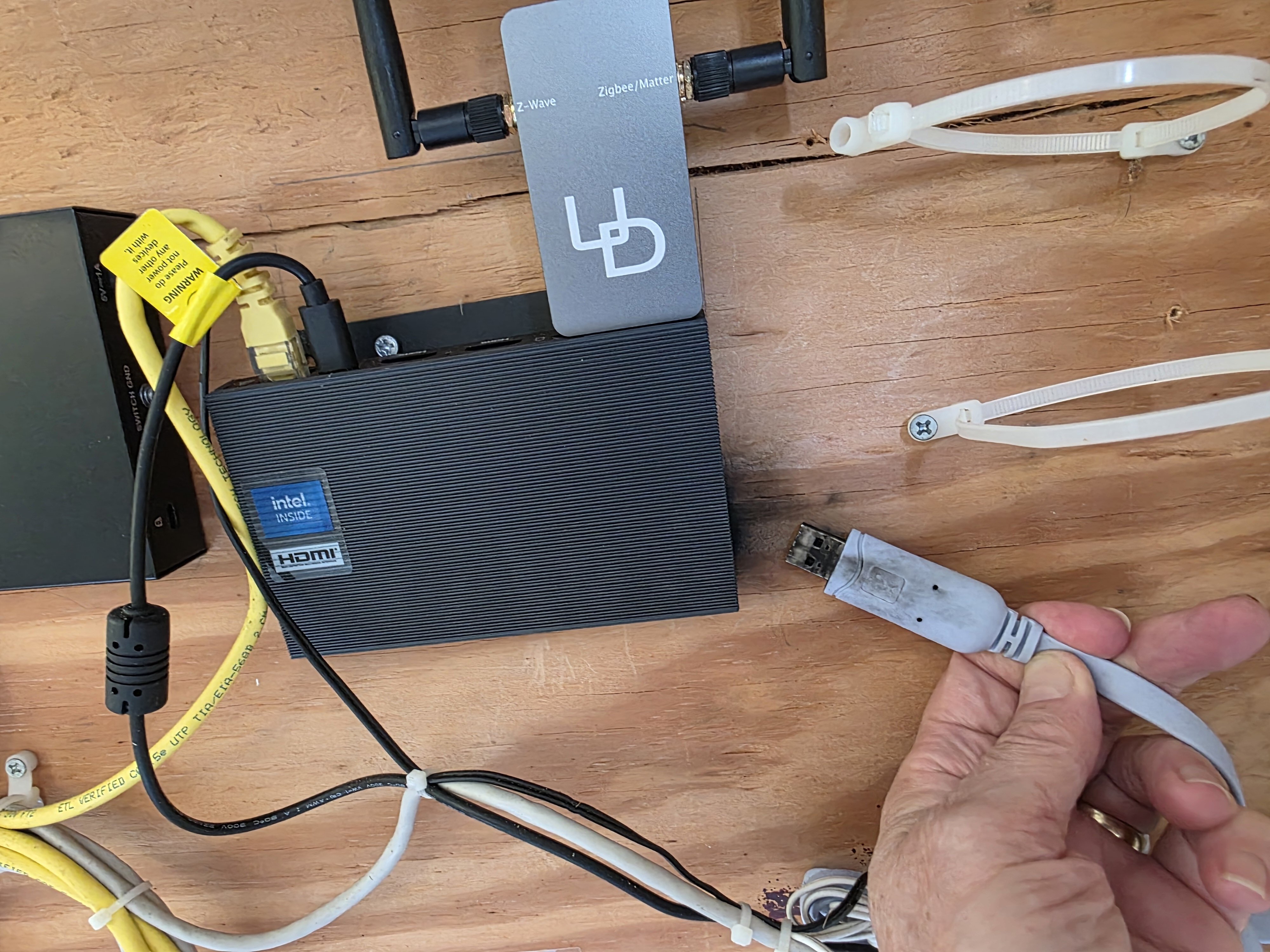

Photos show my dead EISY/ZMatter/PLM + burn marks from the lightning strike.
